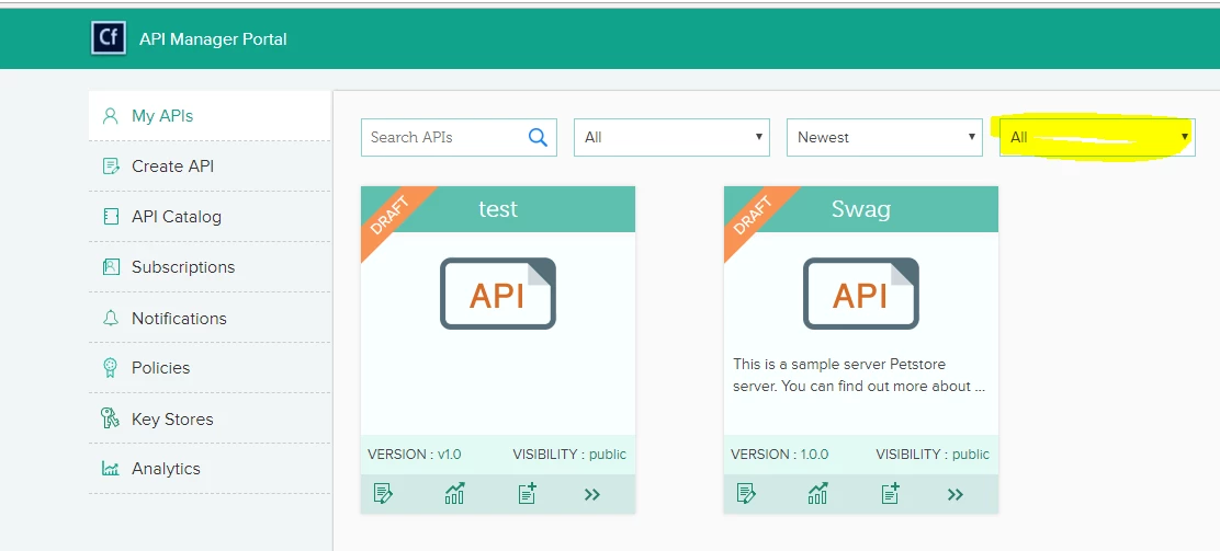

How to delete an API from the CF API Manager Catalog?
Using the CF API Manager Portal, I've added a new API by importing a cfc - using the "Create REST API From SOAP" tool.
I would like to remove it now, but cannot see any button in the Edit screen or elsewhere to do so.
How do I delete an API from the catalog?
Could it be a permissions issue? I see that this UI does not provide the "Update" link mentioned elsewhere.

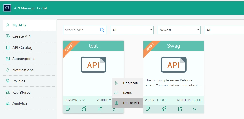

Hi Al,
Please follow the below steps.
1. Log in to http://localhost:9000/portal/  or use your URL.
2. Go to My APIs>Select ALL in all the drop down. Please check the screenshot below.
3. Once you see all your APIs, the bottom of the API, there is a Greater then symbol hover your mouse and click on delete.
Screenshot 1:
Screenshot 2:
Please let me know if this works.

Mar 19, 2018 11:15 PM UTC
Thank you Priyank - this was almost the correct answer.
The APIs were not appearing on this page - under the ALL filter - because they were in DRAFT mode.
Once I set the ALL + DRAFT dropdowns filters - then they appeared.
Perhaps my APIM version needs an update, but there's no UPDATE button.
Thanks again.

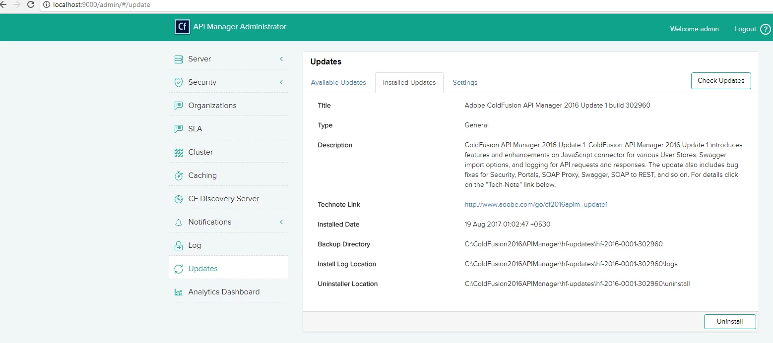

Mar 20, 2018 12:58 PM UTC
Hi Al,
Can you please check the build number and share it.
Priyank
