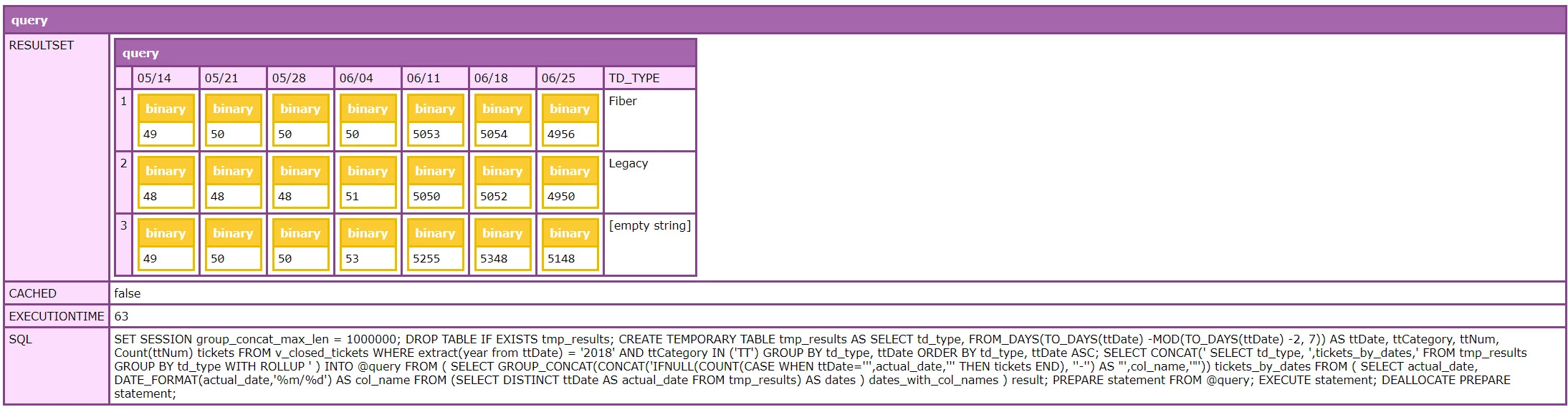

When I call that Stored Procedure using cfdump on my cfm page, I get this:
Questions:
  1. In general, how do you use a "stored procedure" in ColdFusion? (or reference the data?)
  2. Why are the values showing "Binary" and not my actual quantities?
  3. How do I use the correct values to create a regular html table or cfreport?

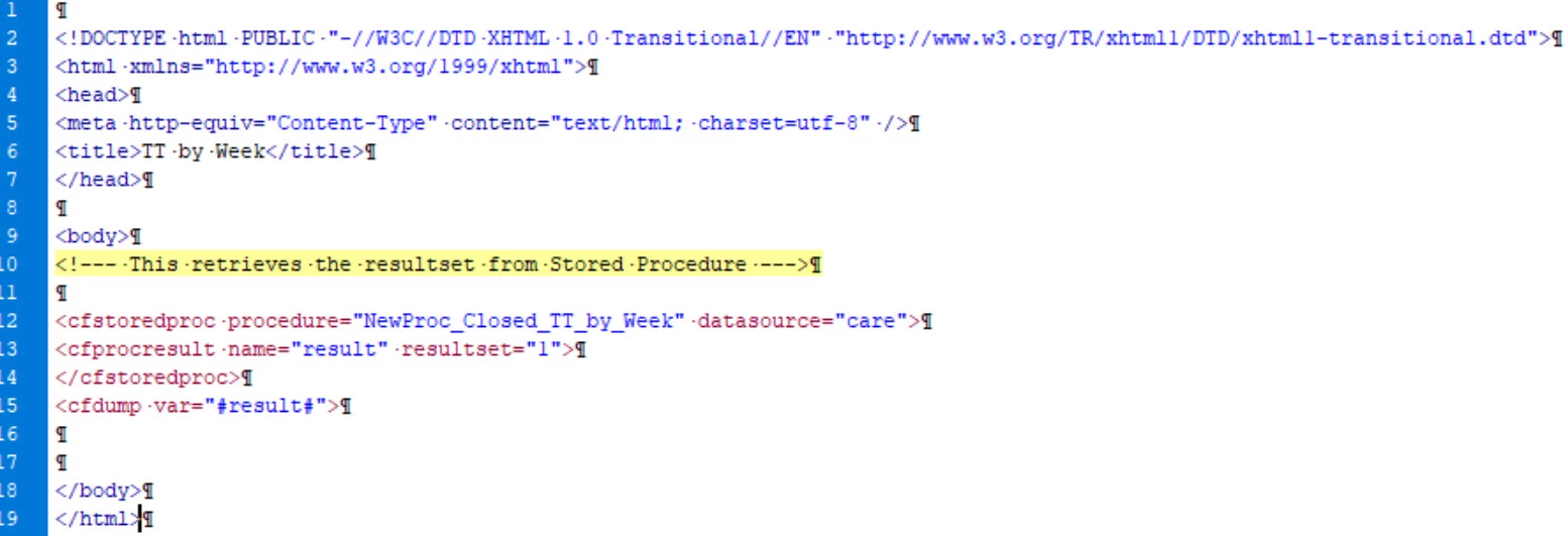

Here is my cfm page so far:

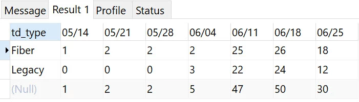

I need my cfm page to display results in a table like this:

I was able to figure this out! Here is the final working cfm page:
<!--- This retrieves the resultset from Stored Procedure "NewProc_Closed_TT_by_Week" --->
<cfstoredproc procedure="NewProc_Closed_TT_by_Week" datasource="care">
<cfprocresult name="rsNewProc_Closed_TT_by_Week" resultset="1">
</cfstoredproc>
<!--- This displays the resultset in a table--->
<cfif IsDefined("rsNewProc_Closed_TT_by_Week.ColumnList")>
<table width="100%" border="1">
<tr style="background: rgba(255,153,51,0.2);">
        <cfloop list="#rsNewProc_Closed_TT_by_Week.ColumnList#" index="col" delimiters=",">
<th align="center" nowrap><cfoutput>#toString(col)#</cfoutput></th>
</cfloop>
        </tr>
<cfoutput query="rsNewProc_Closed_TT_by_Week">
<tr>
        <cfloop list="#rsNewProc_Closed_TT_by_Week.ColumnList#" index="col">
<td align="center" nowrap>#toString(rsNewProc_Closed_TT_by_Week[col][CurrentRow])#</td>
</cfloop>
</tr>
</cfoutput>
</table>
</cfif>
