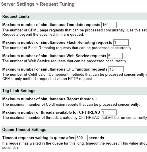

Wow, Karthikeyan.K,
with your set-up you should easily handle thousands of requests, simultaneously and fast. I suspect your settings are throttling down the number of simultaneous requests.
Open the Coldfusion Administrator. Navigate to Server Settings => Request Tuning, and modify the settings accordingly.
Sep 9, 2015 5:53 AM UTC
Please find my setting below and let me know what changes needs to be done to handle thousands of request.
Sep 9, 2015 6:33 AM UTC
Hopefully more than able BKBK can keep working that idea forward.
I am more interested to know what workers.properties (\ColdFusion10\config\wsconfig\N N=1,2,3 or more) and AJP section of server.xml (\ColdFusion11\instance\runtime\conf) says.
Also worth a mention some of the CF10 updaters incremented the tomcat connector but one would have to manually upgrade the ISAPI connector file with WSCONFIG tool since the update process does not do that for you.
Regards, Carl.
