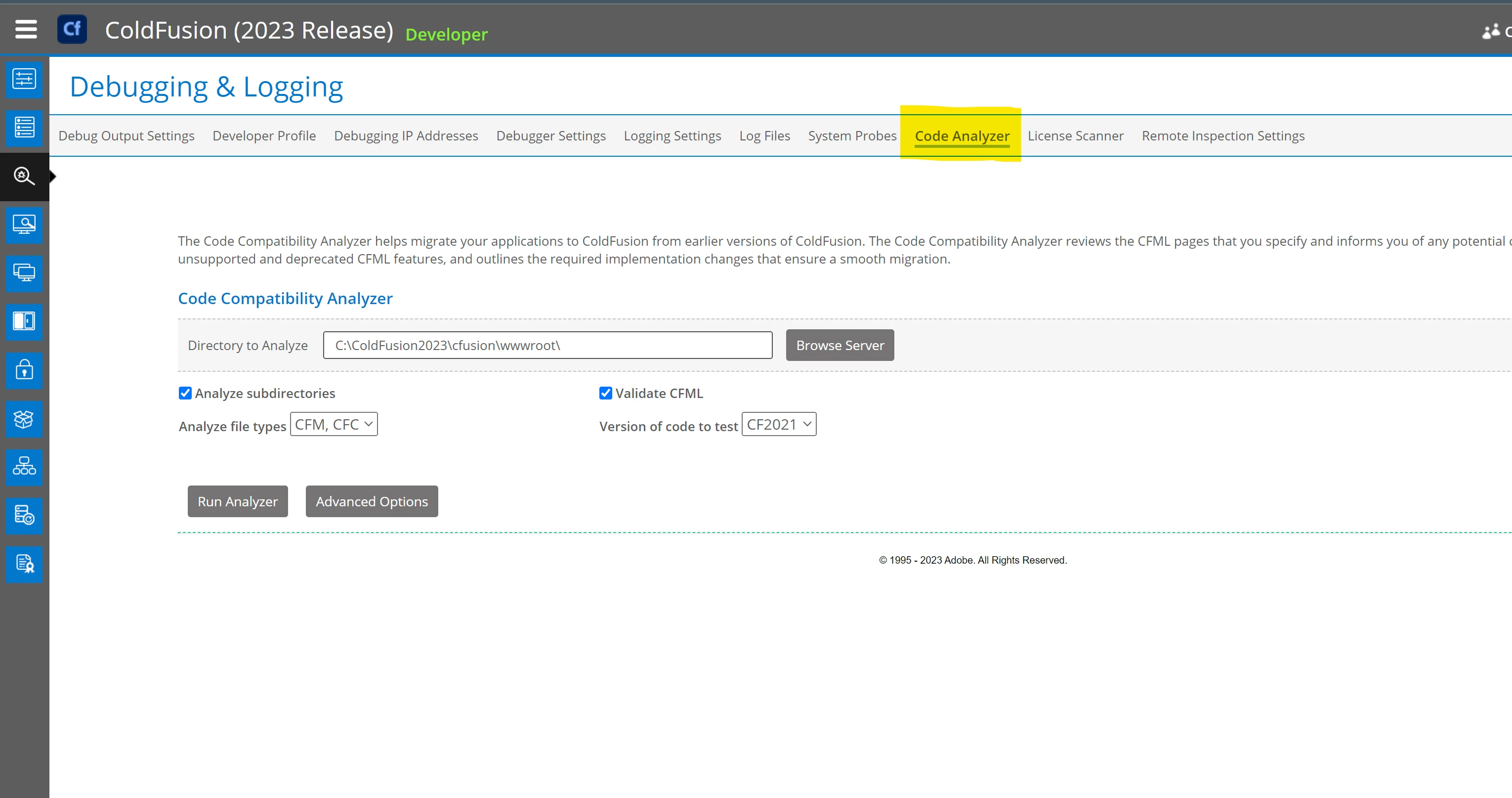

    I plan to upgrade my application from coldfusion 2016 to coldfusion 2023. I need a tool to analyze the source code to see if errors arise in the current source code when upgrading to coldfusion 2023, do you know of any such tool? Thank you.

    May 22, 2024 10:52 AM UTC
    Hi @Quoc373044825aqj
    You can use CF Code Analyzer to run your code and that will give you the result if any changes is required.
    Thanks, Priyank Shrivastava
