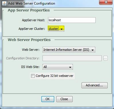

vishu_13Correct answer

Place the files in the wwwroot of both the instances (test1 and test2) and in the website root. Create a cluster using the Web Server Configuration tool using the cluster as shown in the screenshot below
