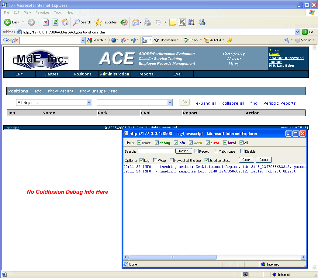

    Thank you for the suggestion. I had already tried that. That gives another overlay window with what I find to be useless information but not the regular Coldfusion debug information. Please see attached screen shot.
    Mike
