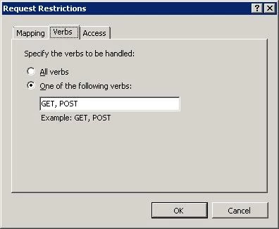

    Not sure if this will help either but have you specified any request restrictions in IIS?  In IIS go to your website and click on the Handler Mappings.  You should have one for '*.cfc', '*.cfm', etc.  Double-click your cfc handler '*.cfc' and it should open the Edit Script Map dialog.  That has a Request Restrictions... button on it.  Click that button and you get the Request Restrictions dialog.  Click on the Verbs tab and see how it is configured.  Compare that one to your cfm handler '*.cfm'.  Any differences?

    I did glance at those and they looked the same.   I went back again after your suggestion and looked again.
    They are identical.
    Mapping is set to "FILE AND FOLDER"
    Verbs is set to "All Verbs"
    Access is set to "Script"
    While I was there, I tried a couple of changes to the cfchandler
    1)  I unchecked "Invoke handler only if request is mapped to ..." .    That didn't seem to change the behavior.
    2)  I unchecked "All verbs" and manually typed in "GET, POST, DELETE, PUT, OPTIONS, HEAD, TRACE, CONNECT".    Again, it didn't seem to change the way the the server was behaving.  The status code isn't being sent.
