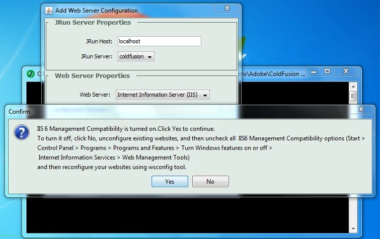

Hi.
I have a problem after the update ColdFusion 9.0.1. Acted in accordance with the instructions here: http://www.adobe.com/support/documentation/en/coldfusion/901/cf901install.pdf
ColdFusion appeared after updating I get an error in the Web Server Configuration Tool
How do I fix this ...?

    I am experiencing the same issue.
    I'm running Windows 2008 R2 SE x64
    I installed ColdFusion 9.
    ColdFusion installed successfully and I was able to get to the ColdFusion Administrator.
    I then followed the documentation installing the 9.01 update.
    I removed the IIS 6 Management compatibility feature.  After that I unconfigured the connector for the site and then reconfigured the connector.
    All I get now is
    Server Error
    Either the Macromedia application server(s) are unreachable or none of them has a mapping to process this request.
    Any help would be greatly appreciated.

    Well, you can simply do what the message tells you to do - uninstall all connectors, disable IIS 6 compatibility, then reinstall the connectors. 9.0.1 no longer requires IIS 6 compatibility. CF 9 and earlier did require this compatibliity.
    Alternatively, you could just click "yes" and ignore this message, and CF 9.0.1 will still work even with IIS 6 compatibility enabled.

    ColdFusion 9.0.1 no longer need the "IIS 6 Compatiblity" features turned on.  The instructions seem to be telling you to go to IIS turn off the "IIS 6 Compatibility" features and then re run the web server configuration tool to reconnect ColdFusion server(s) to the IIS website(s).
    What part of those steps do you need help understanding?
