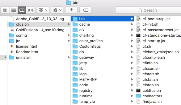

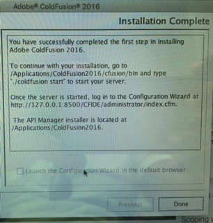

I'm installing a developer profile of ColdFusion 2016 to Mac (Version 10.11.6) and I'm having an issue with completing the installation because I can't run the web server. Per the instructions, I went into my applications directory, ColdFusion2016/cfusion/bin to start the server but I don't know where to type the required "./coldfusion start" to start the server. Please help. Thanks.

    do I add this to the command line terminal on my mac because that didn't work. Thanks.
    Aug 14, 2016 11:57 PM UTC
    Launch Terminal
    Then run this command
    sudo /Applications/ColdFusion2016/cfusion/bin/coldfusion start
