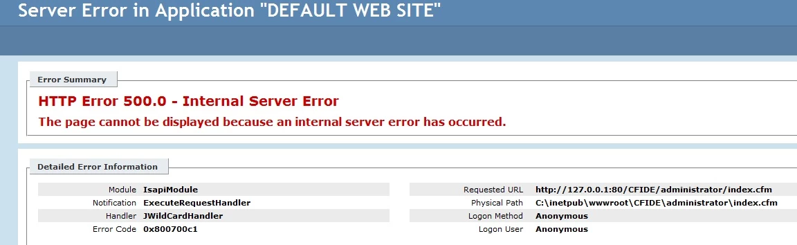

Ok, making a little progress -
I can now display the default page for http://localhost but if I try to go to any other location i get the following:
ModuleIsapiModule
NotificationExecuteRequestHandler
HandlerJWildCardHandler
Error Code0x800700c1
