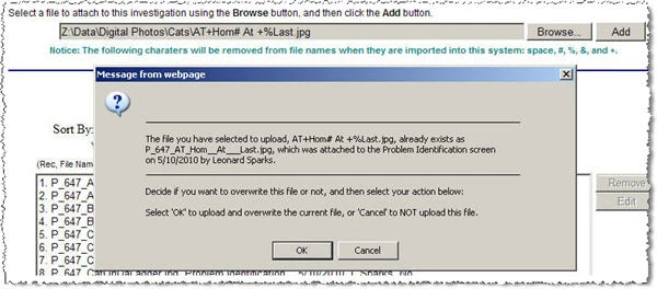

     Thank you for your suggestion, but, after spending the night working with Ben Forta's CF8, vol 2, Chap 34, working with <cfajaxproxy>, I was able to do exactly what I wanted and it appears, after some testing, to work exactly as I had envisoned it should.
     I am now calling a JavaScript function (testFileName) from the onChage event on the <input type="file"> or Browse button, which calls my proxy.cfc that contains the server side of the equation.  This funciton testFileName (I've run out of cleaver function/file names).  The query contained therein hits the database to see if the passed in parameters can pull up an existing file.  If they do, the particulars (file name, data attahced, etc.) are returned to the JavaScipt procedure that puts up the error notice.  The user can then chose to either overwrite the file or quit.  Quiting leaves the your on the Attachment PopUp where he/she started with nothing being uploaded.
