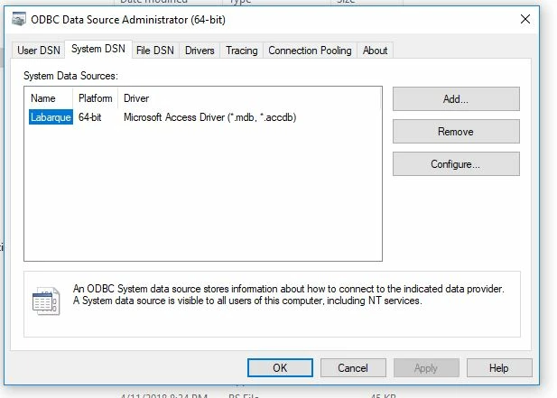

    Please show us a printscreen of the datasource settings for Labarque.
    danbouAuthor
    Aug 26, 2018 2:09 PM UTC
    is this what you mean ?
    thanks
    BKBK
    Aug 26, 2018 2:15 PM UTC
    Thanks for that. However, I meant the settings for Labarque in the ColdFusion Administrator.
