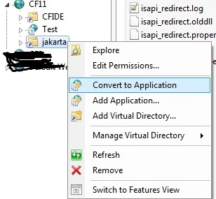

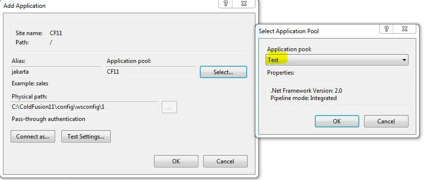

Here are the steps you need to follow:
When you create connector for your ColdFusion 11 website, you get the “Jakarta” as virtual directory added under your website in IIS. If you don't then add 'jakarta' as virtual directory in your website.
You need to right click on “Jakarta” folder and click on “Convert to Application”.
Select the new Application Pool of the Application (say Test) added under website (CF 11)
Click OK. Restart IIS.
NOTE :  You need not to restart IIS as well however if you still face the issue after following the above steps then try to restart IIS.
