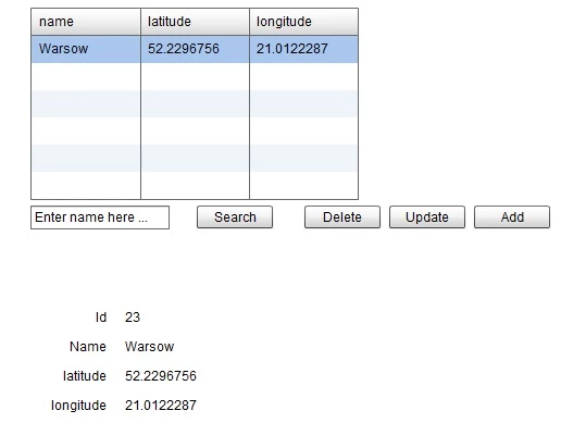

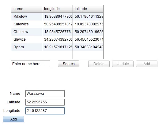

I have a problem with displaying the correct latitude and longitude of my application. And when I want to make changes in the data grid displays a ColdFusion error.
Please help and check the source code.

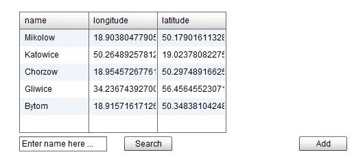

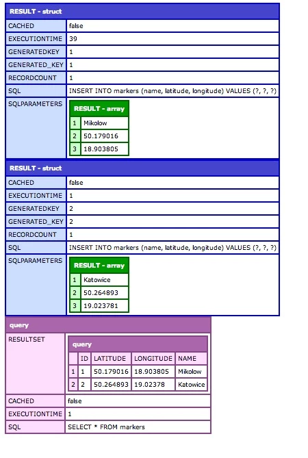

    The FLOAT data is being rounded either in the AMF serialization on directly in the UI.  I think you need to use the Flex NumberFormatter on your FLOAT data.
    http://help.adobe.com/en_US/FlashPlatform/reference/actionscript/3/mx/formatters/NumberFormatter.html
    I tested inserting and querying the data in ColdFusion (without Flex UI) and the data precision is maintained correctly.

    <cfset items = ArrayNew(2)>
    <cfset items[1][1] = 'Mikolow'>
    <cfset items[1][2] = 50.179016>
    <cfset items[1][3] = 18.903805>
    <cfset items[2][1] = 'Katowice'>
    <cfset items[2][2] = 50.264893>
    <cfset items[2][3] = 19.023781>
    <cfloop from="1" to="#arraylen(items)#" index="i">
        <cfquery name="qItem" datasource="map" result="result">
           INSERT INTO markers
                (name, latitude, longitude)
            VALUES
             (<CFQUERYPARAM CFSQLTYPE="CF_SQL_VARCHAR" VALUE="#items[1]#">,
              <CFQUERYPARAM CFSQLTYPE="CF_SQL_FLOAT" VALUE="#items[2]#">,
              <CFQUERYPARAM CFSQLTYPE="CF_SQL_FLOAT" VALUE="#items[3]#">)
         </cfquery>
        <cfdump var="#result#" label="RESULT"/>
    </cfloop>
    <cfquery name="qGetMarkers" datasource="map">
           SELECT *
           FROM markers
    </cfquery>
    <cfdump var="#qGetMarkers#">

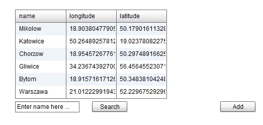

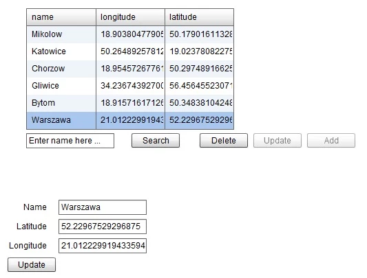

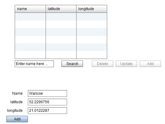

    March 3, 2011

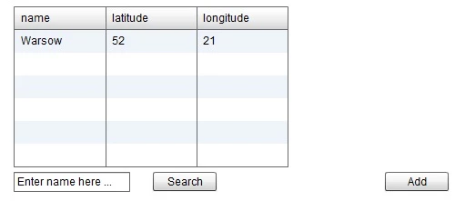

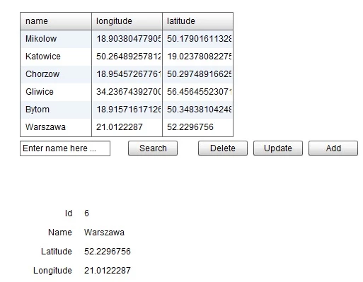

    I changed in the MySQL database with latitude and longitude float (10,6) to Decimal (10,6) when I entered the data (screen_1). Data in the table (screen_2). When re-launching applications, I change the value of latitude longitude (screen_3).
    I do not know why this happens. I could not find the error. Please help me.
