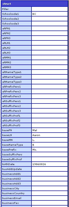

I'm looping each records to create structures. I tried both of this methods successfully (see attachment, I can only post 1 structure in this forum since there are too many elements within 1 structure)
Once I have them all in structures, then I insert each value to a table.
When the feed only contain a few hundred records, I'm OK but when the feed start to get bigger, for example 2500 records, my loop takes too long to create these structures. Sometimes I got a timed-out error. This is my 1st problem.

As you can see from my structure (attached), there are many empty elements within my structures.
This empty elements may contribute to the lengthy looping process.
At first I thought I could do a collection loop within each structure to just get the non empty column and then process them, this will probably cut the proccessing time but I'm facing other problem and that is, the next feed may not have the same exact column with empty value. I'm not sure how can I write the insert into column names if the column are changing every  time.
