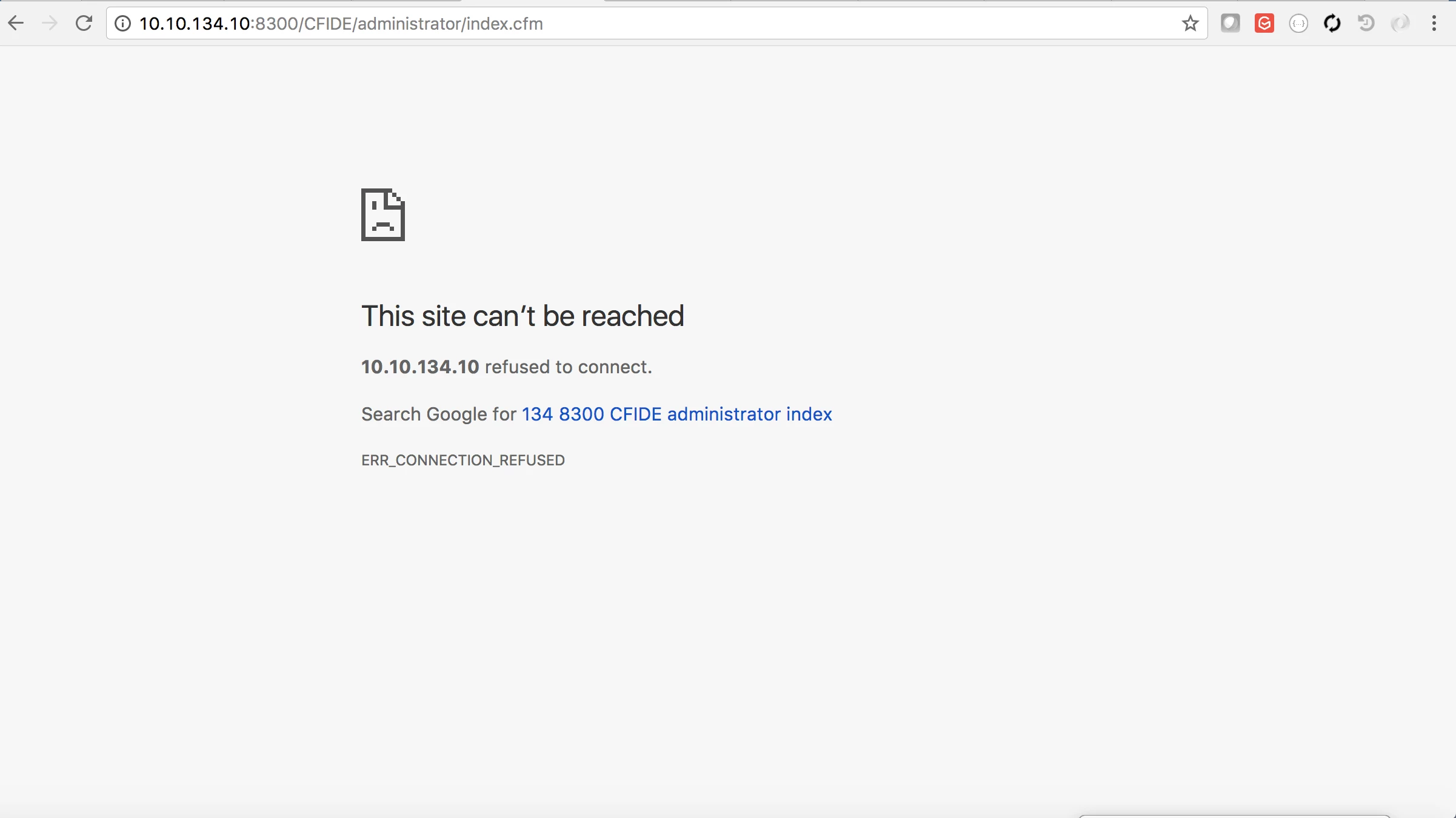

My coldfusion 8 could not be started properly because of some permission problems
Dear,
I'm try to install my coldfusion 8 by following the steps in
Aaron West's Technology Blog: Super Guide: Installing ColdFusion 9 on CentOS Linux
But then I'm facing with permission problem and could not start cfusion 8 properly.
Is there any expertise can help me a look?
Thanks.

[hai.tranthi@ip-10-10-134-10 bin]$ ./jrun start cfusion &
[4] 7549
[hai.tranthi@ip-10-10-134-10 bin]$ Starting Macromedia JRun 4.0 (Build 108673), cfusion server
10/09 10:16:26 info JRun Naming Service listening on *:2902
10/09 10:16:26 error java.io.FileNotFoundException: /opt/jrun4/servers/cfusion/SERVER-INF/connector.properties (Permission denied)
[1]java.io.FileNotFoundException: /opt/jrun4/servers/cfusion/SERVER-INF/connector.properties (Permission denied)

Caused by: java.io.FileNotFoundException: /opt/jrun4/servers/cfusion/SERVER-INF/connector.properties (Permission denied)

java.io.FileNotFoundException: /opt/jrun4/logs/cfusion-event.log (Permission denied)

Thanks Haxtbh for your prompt note,
I have tried
Last login: Mon Oct  9 18:23:31 on console
You have new mail.
Thais-MacBook-Pro:~ chuong$ ssh hai.tranthi@10.10.134.10
hai.tranthi@10.10.134.10's password:
Last login: Mon Oct  9 10:11:27 2017 from ip-10-10-0-72.eu-west-1.compute.internal
       __|  __|_  )
       _|  (     /   Amazon Linux AMI
      ___|\___|___|
https://aws.amazon.com/amazon-linux-ami/2017.03-release-notes/
8 package(s) needed for security, out of 25 available
Run "sudo yum update" to apply all updates.
Amazon Linux version 2017.09 is available.
[hai.tranthi@ip-10-10-134-10 ~]$ sudo /opt/jrun4/bin/jrun stop cfusion &
[1] 8049
[hai.tranthi@ip-10-10-134-10 ~]$ sudo /opt/jrun4/bin/jrun start cfusion &
[2] 8050
[1]+  Stopped                 sudo /opt/jrun4/bin/jrun stop cfusion
But I can’t see anything on the webpage. Seem the server was not started.
Oct 10, 2017 10:42 AM UTC
I assume you run the stop command after checking the page?
