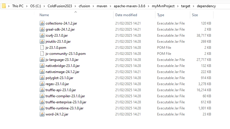

           For example, my C:\ColdFusion2023\cfusion\maven\apache-maven-3.8.6\myMvnProject\target\dependency folder looks like this:

      Then I copied all the contents from C:\ColdFusion2023\cfusion\maven\apache-maven-3.8.6\myMvnProject\target\dependency to the GraalJS_library folder.
