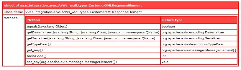

Warning: this is a shot in the dark.
Does a cfdump of a_customerXMLResponseElement.get_any() return an XML document or CF struct?  This Oracle service's "get_any()" method in your cfdump looks similar to how CF interprets .NET datasets returned from a web service.  In a .NET web service the SOAP type "any" is used when the results are to be sent as XML without a specific schema.
Can you post the WSDL for this web service?

Here is the dump of getAny()...
array
1
object of  org.apache.axis.message.MessageElement
Class Nameorg.apache.axis.message.MessageElement

fs22Author
June 30, 2009
Anyone out there have any thoughts on this?
