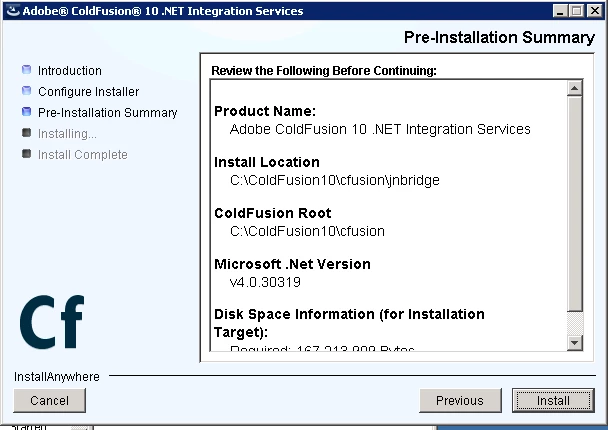

One odd thing that I noticed when running the .Net Integration Service install is that it lists the .Net version as V4.0.30319. However, when I look at Add/Remove programs, it’s telling me the .Net version is 4.5.1. It appears that 4.5.1 was originally installed 12/2/2013 -- and that seemed to work just fine until the most recent .Net 4.5.1 patches.
The documentation I found states the following:  (http://help.adobe.com/en_US/ColdFusion/10.0/Installing/WSc3ff6d0ea77859461172e0811cdec18969-7ff1.html#WSf01dbd23413dda0e2d2de9f211fb1e03c94-8000😞
The installer automatically determines your Windows system .NET Framework version (1.x or 2.0) and installs the appropriate .NET integration software. Both 32-bit and 64-bit systems are supported.
So, it doesn’t seem to be finding the correct version of .Net. Is there any way for me to set or point to the version manually? Or should I uninstall 4.5.1 and try to revert to a 4.0 version of .Net? Could it be that the current version of the CF 10 .Net Integration service doesn't yet support the newest versions of .Net?
