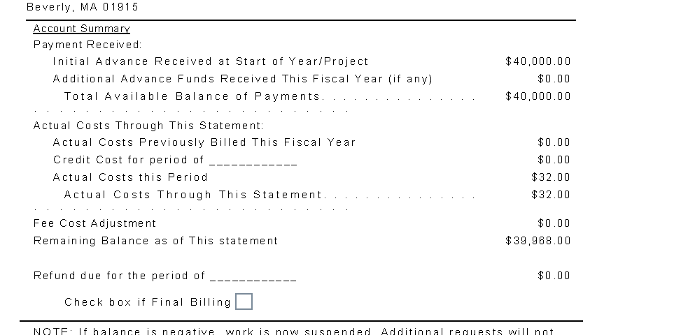

    Yes, I'm on a linux server.  We are in the cloud.  We have all the latest updates.  Issue is specific to cfdocoument.  The spacing in the document is different when I convert pdf.  I create the file in html first and it looks good.  Then when i take the file and do cfdocument pdf it's not correct.
    attached are before and after picture.  Changeafter2021 is not correct.   The second file is the 2016 version which is correct.

    But did you try the simlink offered by gherardo?
    If you did not and would not, because instead you want Adobe t to acknowledge a bug and fix the problem in a subsequent update, this is not the best place for that. Instead, file a bug report at tracker.adobe.com.
    Even then, please let us fellow users know if you would try gherardo's fix and if it works for you.
