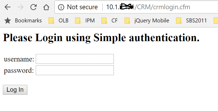

I'm getting the following browser prompt for all pages (in this example, my cf login form is not displaying):

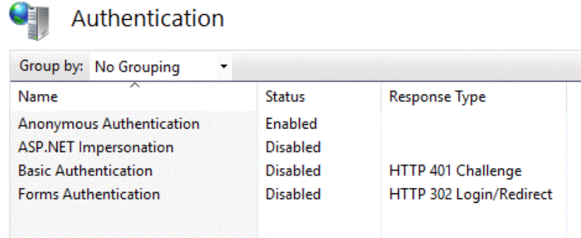

Here is my IIS setting for authentication:

Jan 19, 2018 9:21 PM UTC
Dave, that login image I posted above is what I'm getting on all my pages..

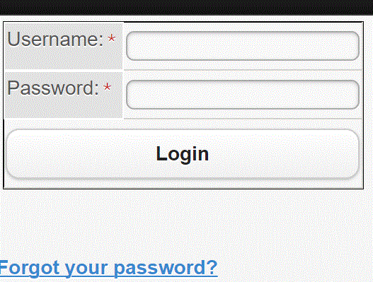

My actual login page (crmlogin.cfm) looks like this:
I can't figure out why none of my pages are being loaded?
