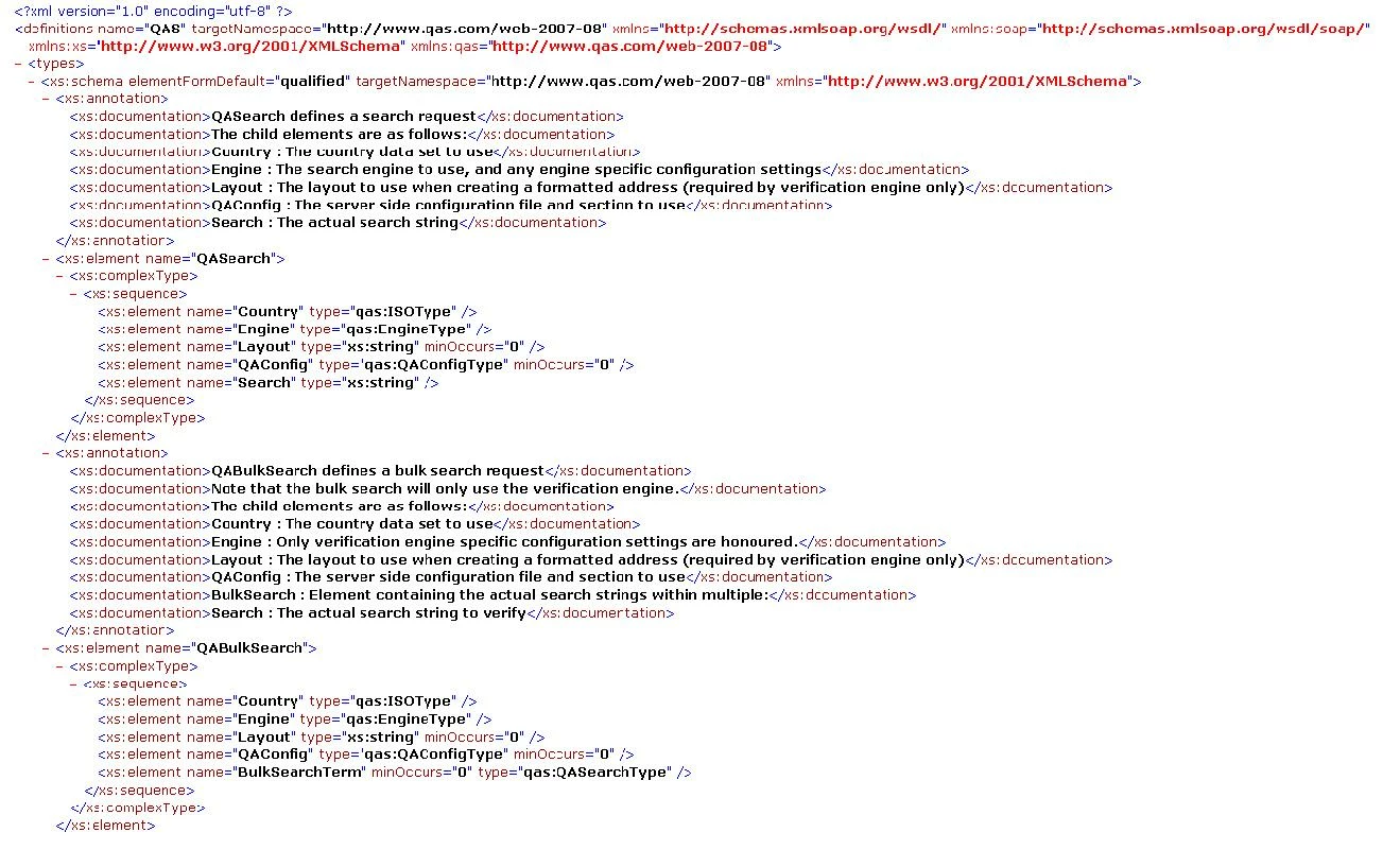

In Production env., we should install this software in prod. web server but in dev. stage I can install the software in my local machine, as it is written in its manual. The url to the wsdl file when it is installed in local machine is referred to as http://localhost:2021/Proweb.wsdl The 2021 is the port where this software is installed. I open up in the browser and I can see the wsdl file display nicely.

In ColdFusion, I tried a couple of approach but unfortunately both are not working and gave the same error:
<cfinvoke webservice="http://localhost:2021/proweb.wsdl" method="DoBulkSearch" returnvariable="retVal">
<cfinvokeargument name="Country" value="USA">
<cfinvokeargument name="Engine" value="Verification">
<cfinvokeargument name="Layout" value="Database layout">
<cfinvokeargument name="Search" value="3223 st. paul street | | | 21218">
</cfinvoke>
<cfdump
var="#retVal#">
My Question is:
How can I pass Country, Engine, Search parameters and tell the remote site that these are structure paramater. In cfinvokeargument there is no "Type" attribute where I can write Type= "Structure"

(screen shot of the wsdl file in text file)
