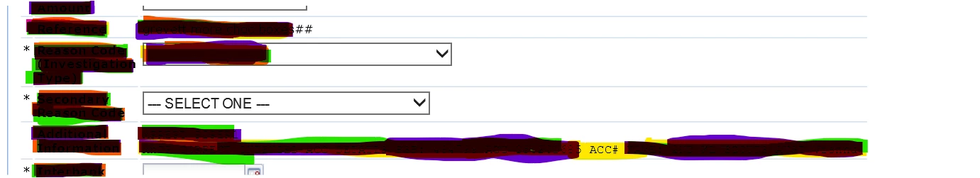

One field displays # and other field displays ##
Team,
In my code I'm trying to dynamically replace the # with ##.
Code is ,
for(key in localStruct.AdditionalFieldsToUpdateStruct)  {
                    localStruct.AdditionalFieldsToUpdateStruct[key] = replace(localStruct.AdditionalFieldsToUpdateStruct[key],'##','####','all');
But while displaying, one field shows # and other shows ##,
Not able to find the reason why this happens,
Can you please help?
Code where the fields are displayed ,
<td class="formRow">
#local.fields[FiName].Display#
</td>

    Hi I expect single # to be displayed in UI.  I added the below fix because, if user enters # in the text area field and saves, error page will occur. This could be because coldfusion doesn't allow single #. The below piece of code is in a  repository, say ABC.
    The below priece of code saves the value from the ABC repo into the database, gets the saved values from database and dsiplays the values in the UI using below code,
    //get the additional field values
    <cfscript>
        local.GetFieldsForRequest = this.GetFieldsForRequest(arguments.ReId);
    </cfscript>
    <cfif local.GetFieldsForRequest.RecordCount>
        <cfset local.fields = structNew()>
        <cfloop query="local.GetFieldsForRequest">
            <cfset local.fields[FiName] = StructNew()>
            <cfset local.configList = TyFiConfiguration>
            <cfset local.fields[FiName] = this.MapConfig(local.configList)>
            <cfset local.fields[FiName].value = ReFiVaValue>
            <cfset local.fields[FiName].required = TyFiRequired>
            <cfif Len(ReFiVaId)>
                <cfset isReadOnly = TyFiReadOnly>
            <cfelse>
                <cfset isReadOnly = false>
            </cfif>
            <cfset local.fields[FiName].readOnly = isReadOnly>
                  <cfsavecontent variable="local.theDisplay"><cfoutput>
                <cfinclude template="Fields\#ReReplace(FiTyName,'[^a-zA-Z]','','all')#.cfm"> <!--- (FiTyName,' ','','all') --->
            </cfoutput></cfsavecontent>
            <cfset local.fields[FiName].Display = local.theDisplay>
        </cfloop>
        <cfoutput>
            <div style="text-align:left; overflow: auto; overflow-x: hidden; height:455px;"> <!--- --->
                <table class="table2008" width="50%">
                    <tr>
                        <th class="reverse" colspan="3" style="text-align:center">Additional Information Fields</th>
                    </tr>
                    <cfset FiGroupName = "">
                    <cfset local.previousGroupName = FiGroupName>
                        <cfset color = "">
                        <cfif structKeyExists(arguments.FieldErrors,FiName)>
                            <cfset color = "color:red;">
                        </cfif>
                        <cfif ListFindNoCase("Hidden Field",FiTyName)>
                        <cfelse>
                            <cfif FiGroupName neq local.previousGroupName>
                                <cfif LEN(FiGroupName)>
                                    <tr>
                                        <th colspan="3">#FiGroupName#</th>
                                    </tr>
                                </cfif>
                            </cfif>
                            <tr>
                                <td class="formRow"style="width:1%;#color#">
                                    <cfif local.fields[FiName].required>
                                    <cfelse>
                                        &nbsp;
                                    </cfif>
                                </td>
                                <td class="formRow " style="font-weight:bold;#color#" width="30%">
                                    #FiDisplayName#
                                </td>
                                    #local.fields[FiName].Display# // Here is where all the field values are displayed
                                </td>
                            </tr>
                        </cfif> <!--- <cfif ListFindNoCase("hidden",FiTyName)> --->
                    </cfloop> <!--- <cfloop query="local.GetFieldsForRequest"> --->
                </table>
            </div>
        </cfoutput>
    </cfif>
    I also checked the database and can confirm that values of both the fields A and B in database have %23%23(in encoded format which is ##)
    Let's assume the value sent to the system for field A (text field)  is "This is Vishnu. My id is #124."
    Similarly the value sent to the system for field B (text area field) is "This is Ragav.My id is #234"
    When we check in the UI,
    The field A is displayed as ->   This is Vishnu. My id is ##124.
    The field B is displayd as  ->    This is Ragav.My id is #234
    Please let me know if mre information is required. Thanks
