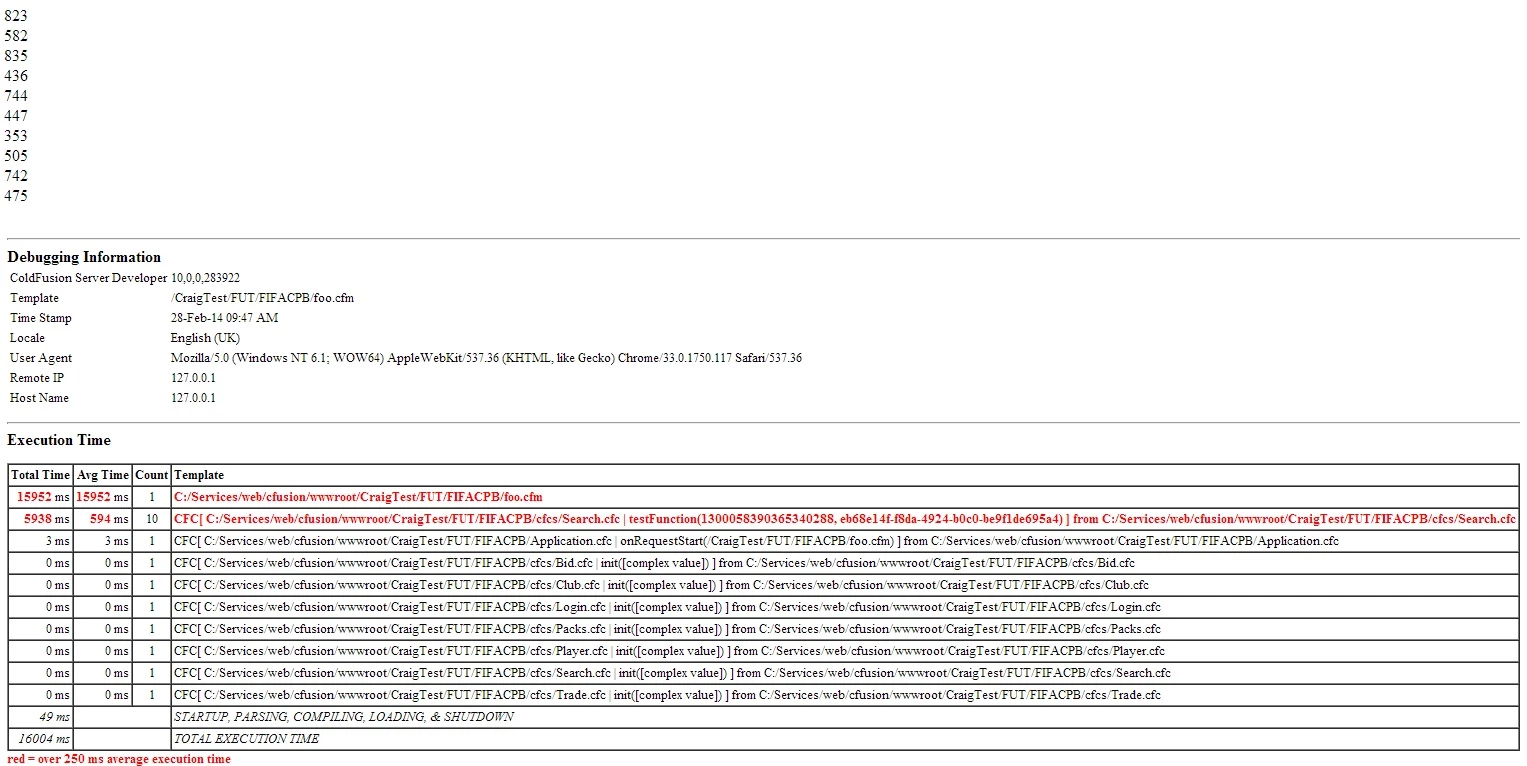

    Below is a screen dump of the test page I set up which makes 10 requests to a test function. The test function makes a standard CFHTTP call. Each request is timed and the time output on the page.
    From what's there it gives no insight to me of what is actually happening or causing the requests to take so long to complete.
    I've had a look around online the last few hours for web socket example but can find nothing other than creating a chat room! Do you have a link to any material or pseudo code that would allow me to create a test page that used web sockets so I could make a comparison between the request times?

    I thought your application involved just CFM pages that implement CFHTTP. Hence my suggestion to enable Debugging Output in the Administrator.
    From the look of it, your application involves invoking CFCs. This calls for a change of plan. You should de-activate Debugging Output. It is a very blunt instrument in the circumstances.
    The cftimer tag or getTickCount function are more appropriate. I guess you are using them already.
    The question remains how to crank up the speed in this new setting. Invoking a function in a CFC to interact with a remote server can be costly in CPU terms. I'll have a think.
