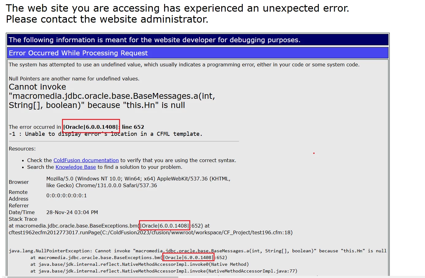

    I have found a way to trick ColdFusion into revealing the full version of the Datadirect Oracle driver.
    <cfset baseExceptionsObject=createobject("java","macromedia.jdbc.oracle.base.BaseExceptions")>
    <!---<cfdump var="#baseExceptionsObject#" label="macromedia.jdbc.oracle.base.BaseExceptions object"><br>--->
    <!--- Deliberate fake call, causing an error. The error message should, we hope, reveal the version --->
    <cfoutput>#baseExceptionsObject.bm(-1)#</cfoutput>
    The result on ColdFusion 2023 Update 11:

    Someone once asked a related question: on how to fix an ArrayCopy Out Of Bounds Error. The question contains a clue.  You will see that the error message in that post contains lines such as
    at macromedia.jdbc.oracle.base.BaseExceptions.b(|Oracle|6.0.0.1051|:1102)
    at macromedia.jdbc.oracle.base.BaseExceptions.a(|Oracle|6.0.0.1051|:976)
    at macromedia.jdbc.oracle.base.BaseExceptions.b(|Oracle|6.0.0.1051|:1128)
    at macromedia.jdbc.oracle.base.BaseExceptions.b(|Oracle|6.0.0.1051|:796)
    at macromedia.jdbc.oracle.OracleImplConnection.open(|Oracle|6.0.0.1051|:2602)
    I'm guessing that 6.0.0.1051 refers to the version. So, take a look at your own error messages. Do you see a similar string?

    BKBKCommunity ExpertCorrect answer
    Nov 28, 2024 2:10 PM UTC
