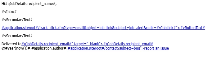

I have HTML code, containing dynamic variables, stored in a database in a field named "data',. An example of raw data in that field would be:
<a href="<cfoutput>#application.siteroot#</cfoutput>/?utm_campaign=transactional&utm_source=emails.logo&utm_medium=email"><img src="<cfoutput>#application.siteroot/logo10-180.png"></a>
Within a cfc, I have code that sets this data in a <cfcontent> tag as follows:
<cfsavecontent variable="emailBody">
  <cfoutput>#vData#</cfoutput>
</cfsavecontent>
However, when I tried to insert "emailBody" into an email and send it, the resulting email does not evaluate the variables in the email body and the email ends up looking like this:
What am I doing wrong?

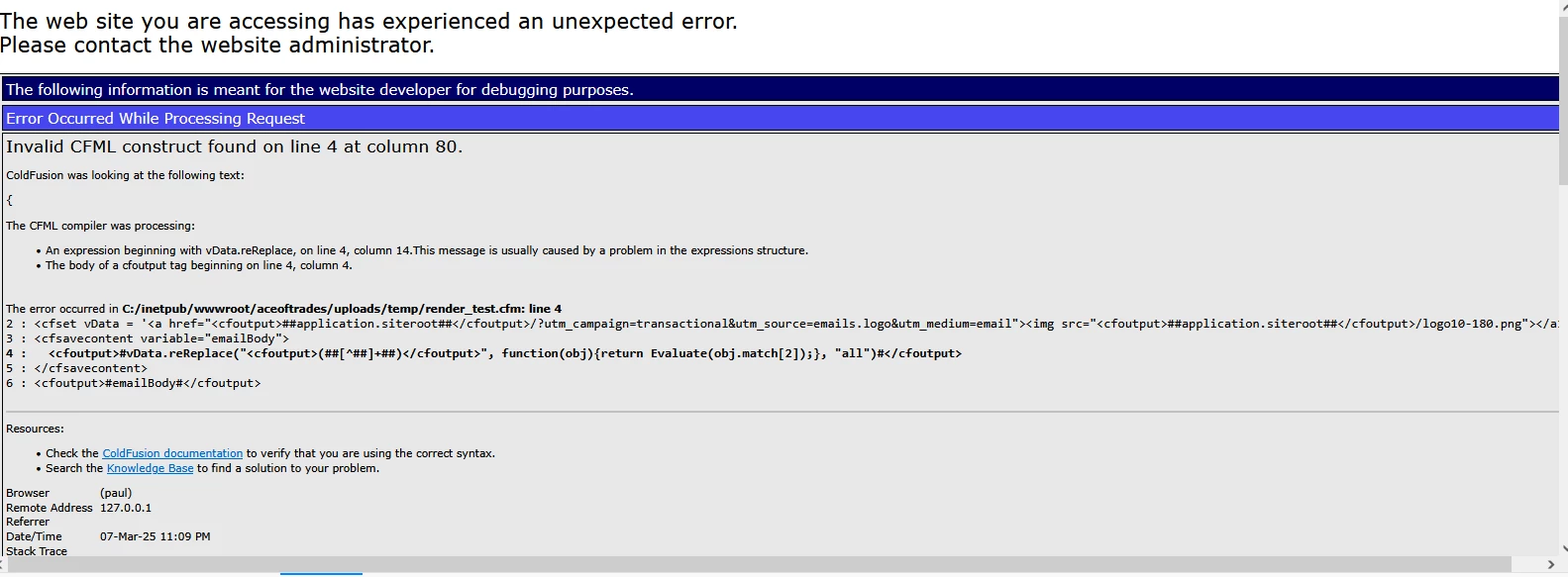

    March 7, 2025
    <cfset application.siteroot = "https://example.com">
    <cfset vData = '<a href="<cfoutput>##application.siteroot##</cfoutput>/?utm_campaign=transactional&utm_source=emails.logo&utm_medium=email"><img src="<cfoutput>##application.siteroot##</cfoutput>/logo10-180.png"></a>'>
      <cfoutput>#vData.reReplace("<cfoutput>(##[^##]+##)</cfoutput>", function(obj){return Evaluate(obj.match[2]);}, "all")#</cfoutput>
    </cfsavecontent>
    <cfoutput>#emailBody#</cfoutput>
    paul_8809Author
    March 7, 2025
    Thanks for replying! This throws an error, as follows:
    March 7, 2025
