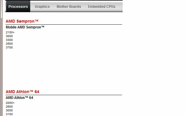

    Here's a screen of what my code returns:
    This is what I would like it to look like minus the extra spaces beneath the models due to empty fields in the table:
    I think the last statement you made might be closer to my situation, "model1" is a column in my recordset. There are seven of these that may or maynot have data in them. I don't want to display the ones that don't have data in them in order to eliminate the extra spacing. Please forgive the old CF code, it's been about 10 years since I've last used Coldfusion and haven't kept up with the new tags.
    That right there is a clear statement of a database design the needs to be normalized.  You shouldn't have seven columns for models.  (What happens the first time this database needs to store eight models for a family?)  You should have a models table that has rows for each model connected to the family record with a foreign key.  Then it would be a simple matter of a SQL join statement and a <cfoutput group....> recordset loop to output the display you want.
    But if you are unwilling or unable to professionally normalize your database design.  You are not checking for missing "parameters' or "structure keys".  They will never be missing.  All seven columns will always exist in the record set, if you select them from the database.
    What you need to be checking for is "empty" values.  ColdFusion record sets don't really have NULL values, so just check for empty strings.
    <cfif len(trim(proces.model1) IS NOT 0><cfoutput>#Procs.Model1#<br></cfoutput></cfif>
