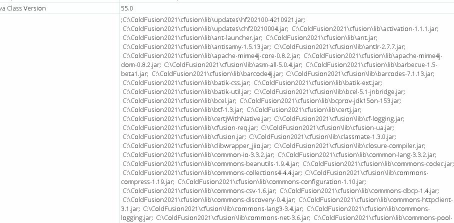

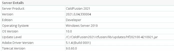

    March 2, 2023
    Thanks Charlie for your response.
    For your information I am already using update 4 of cf2021 but again I have configured .jar file and updated as per recomended in  URL https://helpx.adobe.com/coldfusion/kb/dateformat-function-coldfusion-2021.html
    Still issue is same, it's not resolved.
    Charlie Arehart
    March 2, 2023
    As I said, "You do NOT need to download the offered jar, if you are beyond update 1 of cf2021 (but you DO still need to add the jvm argument to revert the behavior".
    So take out that jar you added. And did you add the jvm arg? See my post for more.
    /Charlie (troubleshooter, carehart. org)
