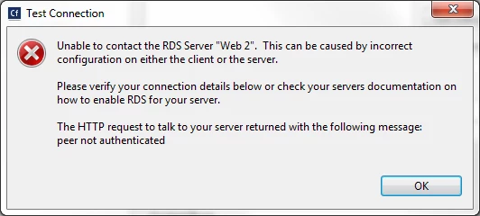

bgordon8684
Jun 23, 2015 8:17 PM UTC
Hi, Charlie.  Thanks for the reply.
Upper right corner, right click on server, then "RDS Configuration".  Test connection returns this:
Also at the bottom under "CF Servers" with same setup, if I "Start Server", status says "Starting" and stays there forever.

Charlie Arehart
Jun 23, 2015 8:35 PM UTC
Well, let’s clarify first that the RDS config test and the server view are quite different. The latter does NOT rely on RDS (there are facets of the configuration of a server there which DO rely on RDS, but not that “start/stop” status). As for why it remains stuck showing the “starting” status, I don’t readily know, but guess the question would be first “does the server run or not?”, and seconddo you need to be concerned about this status?
So back to the RDS test, this error suggests you are connecting to the server via SSL. Can you confirm that? And when you say that the HomeSite+ setup is identical, are you saying it uses HTTP in its url also?
And when you say these are both connecting to the “same server”, is the URL you’re using also otherwise identical? For instance, you could connect to “the same server” but use 2 different domain names, connecting to the one web server but in different ways. Finally, are you in fact making the connection to CF through a web server (IIS or Apache) or directly using CF’s built-in web server (such as if using port 8500 or the like in your URL)?
