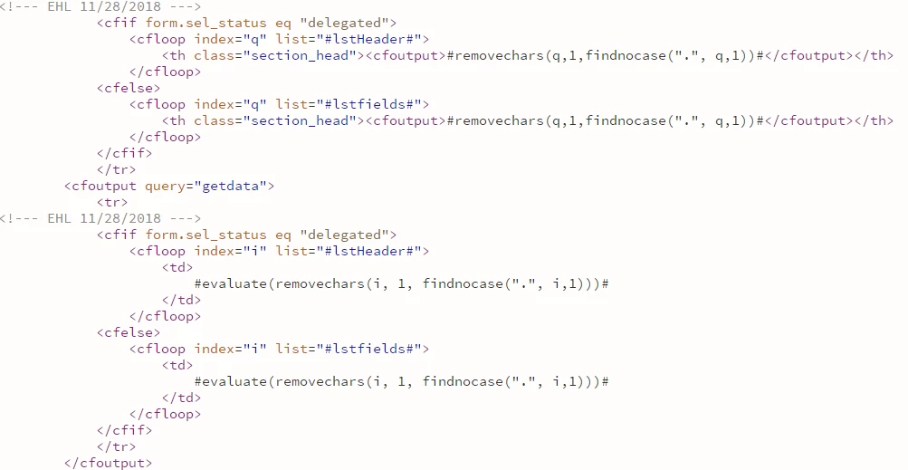

The problem is when I get to the point where I am outputting this to Excel from within the ColdFusion application. The code that does this is:
When I run this code 2 things happen that are not what I am looking for.  First the column name is not what the alias should be:
Second I am getting this error when I am processing the results of the query:
Until I added the modified column into the query this worked correctly.
I suspect it is some simple syntax issue but I am not sure how to look for it.

    ericl66518797Correct answer
    Nov 28, 2018 7:02 PM UTC
    With a new day and fresh Eyes I was able to come up with a way to make it do what I want it to do. Since when I am building query string I am using a <cfif> tag to change how the query is built I used the same if  logic to save what the fields should be later when I am outputting the the data I am using the correct data to output the results.  I am now using this code and it is working.  I have solved my own problem.  It may not be the most elegant way of ding it but it does what I need it to do.

    WolfShade
    Nov 28, 2018 4:08 PM UTC
    First, I would never use evaluate for anything.  Ever.
    Second, you have an extra ) at the end of the evaluate; you open with two but close with three.  That's throwing CF off track.
