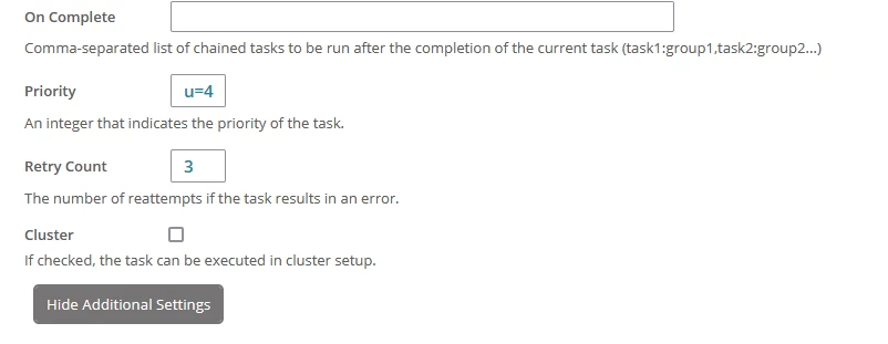

Greetings one and all -
I recently tried to create a new scheduled task, and I made enough of them over the years that it should be an issue.
I go through the process, and the get this message:
An error occurred scheduling the task.
For input string: "u=4"
I have no idea where or what this message is referring to.
I look under the Additional Settings, and under Priority in the input field it shows:
u=4.
I know I didn't enter it.
When I change it, it resets it back to 'u=4,' and I get the error message again.
No matter what value I choose, (blank or a number), I get the error message, and the value is back to u=4.
Any and all help is appreciated.
Thanks

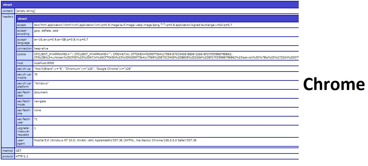

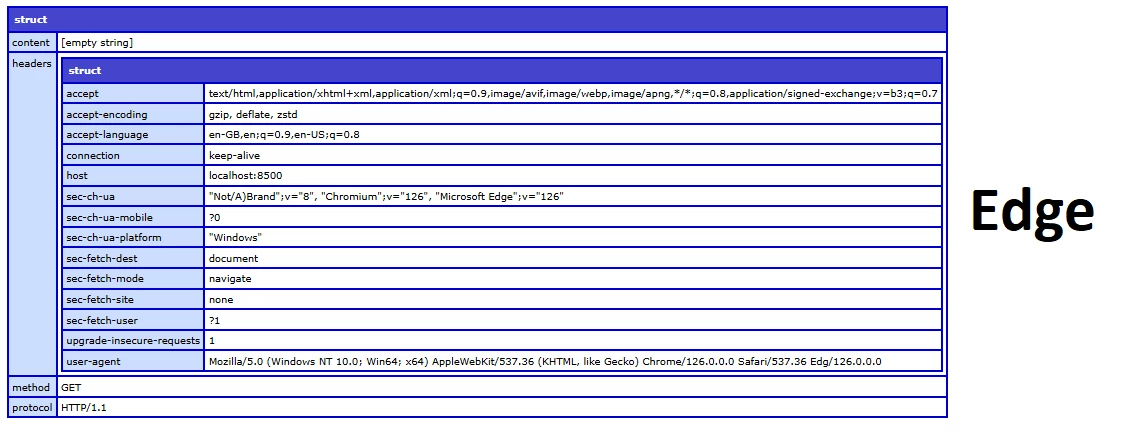

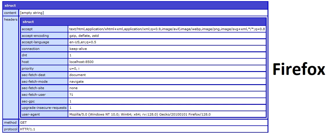

    1.  Likely cause: Steps to reproduce
    1.1  Save the following line of code as a CFM file.
    <cfdump var="#getHTTPRequestData()#">
    1.2  Launch the code, in turn, on the most recent versions of the browsers Chrome, Firefox and Edge.
    A picture of the result:
    1.3  Take a look at the headers. You will see that Firefox, and Firefox alone, has the PRIORITY header. The value of this header is in the form "u=N", where u denotes urgency and N is an integer between 0 and 7 inclusive. My hypothesis is that that is where the "u=4" in the error comes from.
    It just so happens that the scheduled-tasks form in the ColdFusion Administrator has a field named PRIORITY.

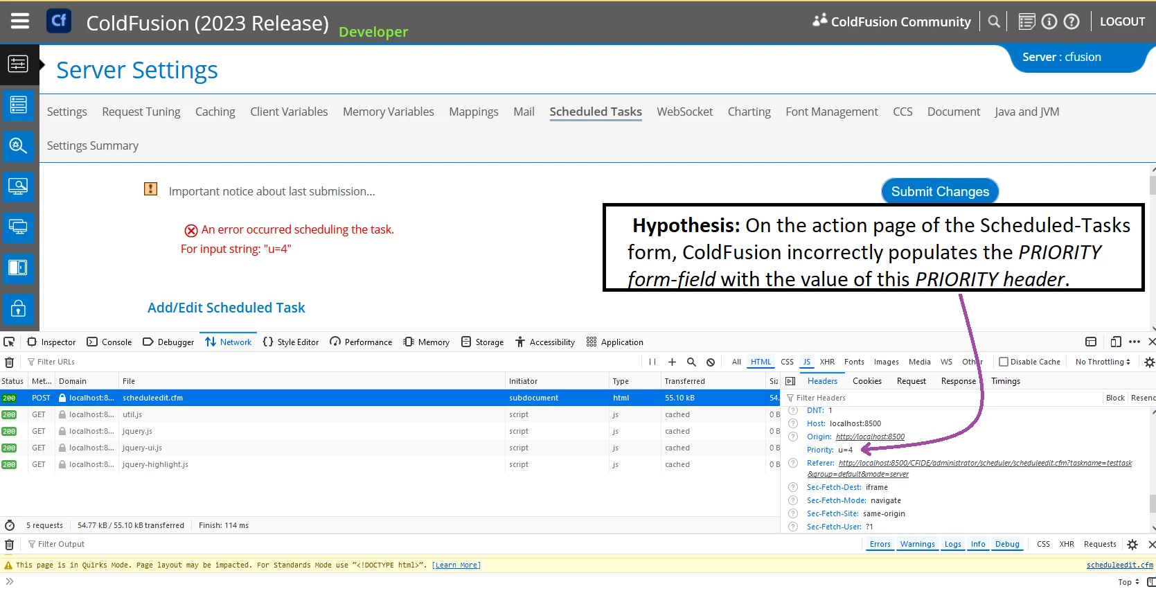

    My hypothesis is that the following happens in the action-page of the ColdFusion Administrator when it processes the scheduled-task form. It incorrectly populates the PRIORITY form-field with the value of the PRIORITY header.
    1.4  Steps to demonstrate the issue:
    (a) Open the ColdFusion Administrator in Firefox. Create a new scheduled-task in the Administrator.
    (b) Close then restart the ColdFusion Administrator, and go to the Scheduled Tasks page.
    (c) Click on the button to edit the task you created in step (a).
    (d) Press F12 to launch Developer Tools.
    (e) Click on the button Submit Changes.
    1.5  Examine the request headers in Developer Tools. You will see the PRIORITY request-header. Its value is "u=4".

    Jul 18, 2024 3:58 PM UTC
    I'm having the same issue! Very frustrating and I can't create or edit any scheduled task for the past 3-4 weeks I'd say. I'm on Coldfusion 2021 Enterprise Update 14. This was an issue on update 13 as well. It wasn't on 12. I've been on CF 2021 for a while. I haven't upgraded from a previous version recently.
    For any scheduled task (new or current) I submit changes and it always says "An error occurred scheduling the task. For input string: "u=4"". I found the u=4 under additional settings -> priority. I don't add u=4 there. No idea why it keeps showing up. I clear it out, or also change the priority to 5 (seemed to be what it should be maybe) and click on Submit changes and it gives me the same error. I check priority again and it's back to u=4.
    I don't see anything in the logs really. Seems like a client side issue almost. I've tried in Chrome and Firefox on my laptop and on a Windows server. Same issue everywhere.
