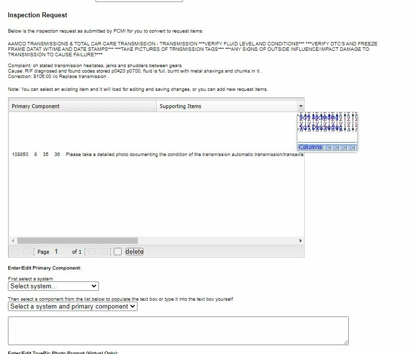

We are having a problem with cfgrid displaying column data inside the grid even though the columns are set to not display. Worked fine until yesterday. Have an office full of chrome users with the same issue. It seems like cfgrid uses different html for chrome than it does for firefox and there is a table with a class of x-grid-table-resizer. The first row columns set the width and hright to zero like this:
<TH class="x-grid-col-resizer-request_grid_REQUEST_ITEM_ID" style="width: 0px; height: 0px;">
</TH>
The data rows are like this:
<TD class=" x-grid-cell x-grid-cell-request_grid_REQUEST_ITEM_ID x-grid-cell-first">
<DIV class="x-grid-cell-inner " style="text-align: left; ;"> 99917
</DIV>
</TD>
The problem is that the data rows are still displaying inside the grid even though the width and height on the first row cells are zero?  Firefox does not create this resizer table at all and works fine. So does Edge and my Chrome even though it is the same version as the other users having the problem.
It looks like Chrome refuses to set the width to zero to hide the columns set not to display.
If anyone can help it would be greatly appreciated as curently it makes cfgrid not useable for us and our system depends on it.

    Oct 15, 2024 12:34 PM UTC
    The cfgrid tag generates the html, and the html it generates no longer works correctly in Chrome. Grid columns set not to display are hidden in the column header bar, but are displaying as text inside the grid itself

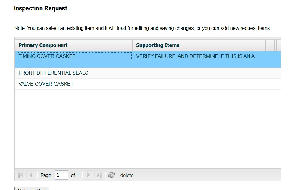

    Attached is an example of what is displayed inside the grid control instead of just the two columns that should display that you see in the header row. Also you can see the dropdown in header columns is a mess. The text you see inside the grid is the content of the columns set NOT to display in the grid. I managed a workaround by setting the hidden columns to display and moving them to the right of the two columns we needed to see and setting their width to 5 pixels, but would rather have the grid work like it did three days ago
    I also attached what the grid displays like after applying my changes above. At least now grid rows can be read and clicked to edit them
