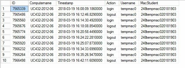

So for testing purposes say I have the following records retrieved:
I need to be able to loop through all the records and then calculate time between a login event and only the NEXT logout event.
So for the example recordset above - I would expect to calculate 25 mins use recorded. but at the moment i cant figure out how to ignore the rest of the logouts as when i do my loop it takes the first login and calculates the time against ALL the logouts, then moves to the second login event and calculates the time against ALL the logouts below that and it carries on until the loop finishes.

I would like to mention that you don't need to do two separate queries and compare.  You can do this with one query.  As far as which record is login and which is logout, if your database is as per the image provided, then you're already registering the login / logout, you just need to sort by user then timestamp (I hope you didn't really name the column 'timestamp') as shown in the image.  This helps to assure that all odd-numbered rows will be login and all the even numbered rows will be logoff.

I did try the one query and sorting by User/Timestamp but it doesn't necessarily mean that odd numbers are logins and even numbers are logouts as a single user can login to multiple computers, so by doing  user/timestamp I can have several rows together showing as login.
