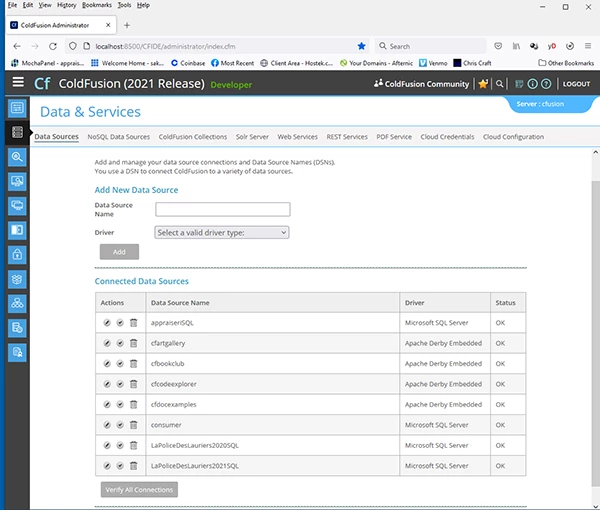

    Yes if you mean are my db's registered & connected in my local CF admin (see attached).

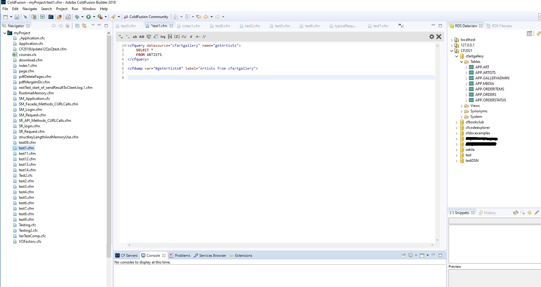

    @seasonedweb , I have followed the discussion. I want to zoom in on ColdFusion Builder, because your question mentions it. In so doing, I may be repeating a point you've all mulled over. Are you willing to backtrack a bit?
    The answer to your question is: yes, you can achieve that database functionality with ColdFusion Builder! In fact, I do believe Builder does what you want better than Homesite.
    The version I am thinking of is ColdFusion Builder 2018 (v3.2.x). Just install it on your local machine and, when you do, enable RDS. The rest follows from there.
    I have attached a picture showing RDS in use in ColdFusion Builder 2018.
