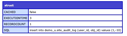

I can tell you that since CF11 and as recently as CF2018 U9, that the result.generatedkey most certainly does not consistantly contain the auto generated key (though it claims it does).  In fact I just ran a test in case I had been just missing it with a simple table and dumped out the result and as you can see there is not even a GeneratedKey value returned:
FYI this is running CF2018 U9 with PostgreSQL 10.10
So instead when we need to retrieve the ID that was generated we execute a statement like:
insert into demo_u.site_audit_log (user_id, obj_id) values (1,-10) returning ID;
I know some DB's support this, so you may be able to go that route if your DB supports it.

The result struct from your insert query should have contained the Generated-Key key.
Please report a bug.
