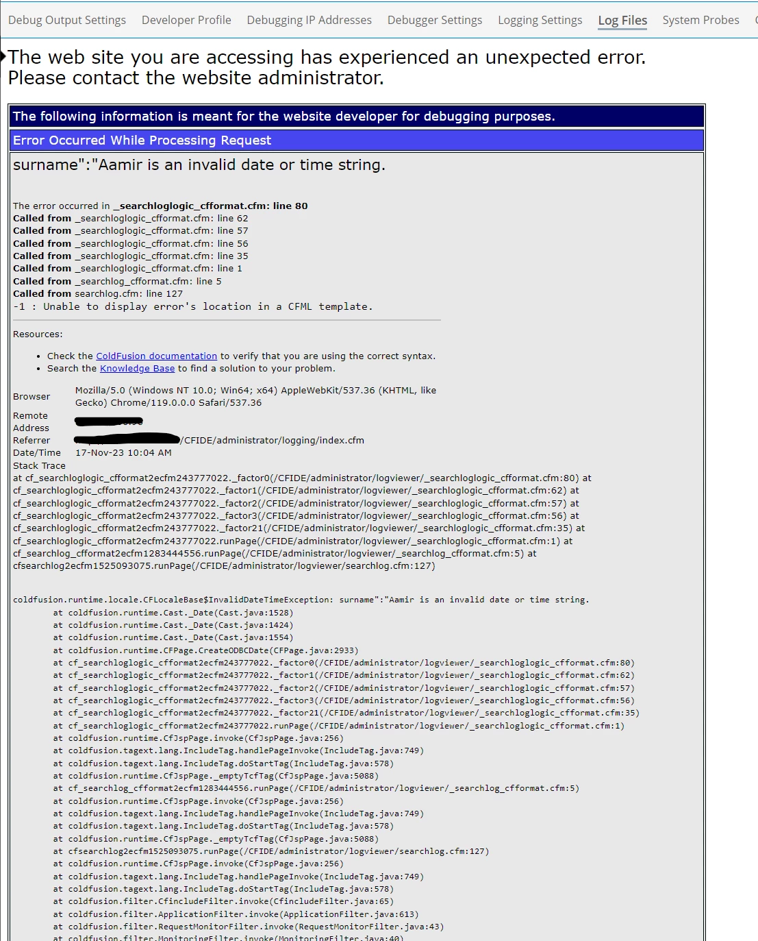

I've also noticed that I now can't access some of the Coldfusion logs. I'm getting the error below.

    Yours is a very common problem, but there's no single problem that it will definitely be. Still, it's not an impossible problem tonsokve. Before considering the cfquery or log viewer errors (which may be transient), let's focus on your more important slow diwn/hangup/503.
