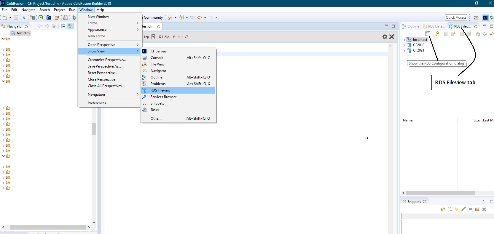

Create a ColdFusion project in ColdFusion Builder, if you haven't yet done so. If you have, open the project in CF Builder. Ensure that you can run a test CFM page from CF Builder. That shows that your settings are OK.
Now, open the RDS Fileviewer. To do so, navigate to Window >  Showview > RDS Fileview.

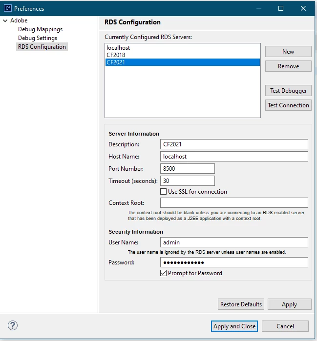

Click on the button to Show RDS Configuration dialog. You will get the following user interface:
Choose the appropriate server (CF2021 in my case). Share with us the RDS connection settings.
