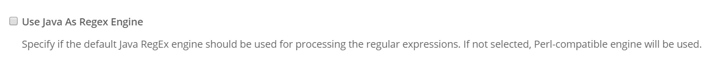

You can also enable the option at the serve. Enable the option Use Java As Regex Engine, located in Server Settings > Settings of the ColdFusion Administrator.
For more information, see Using the ColdFusion Administrator.
