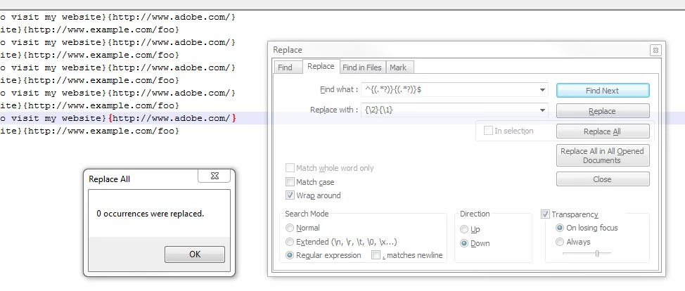

April 19, 2013
Thank you Duncan, but I can't seem to get this to work in Dreamweaver or Notepad++.
