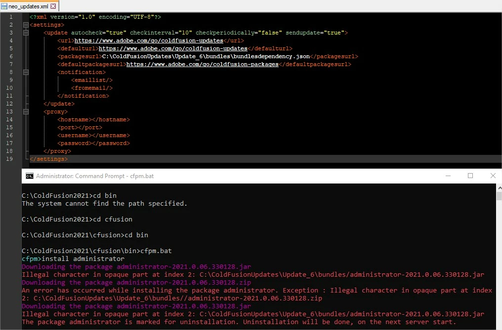

    After installing Update 6 on ColdFusion 2021 via the offline steps. I was prompted to with a message saying "The administrator module is not installed" and asking me to install the administrator package via the CLI package manager.
    I never had this happen on the last 5 updates of CF 2021. Is this expected with this update?
    March 15, 2023
    Further to this, when actually attempting to reinstall the administrator package I receive the following from the cfpm:
    Adobe Employee
    March 15, 2023
    your neo-updates xml suggests a local custom dependency json.. and the error suggests an error possibly parsing either the filepath or its contents.
