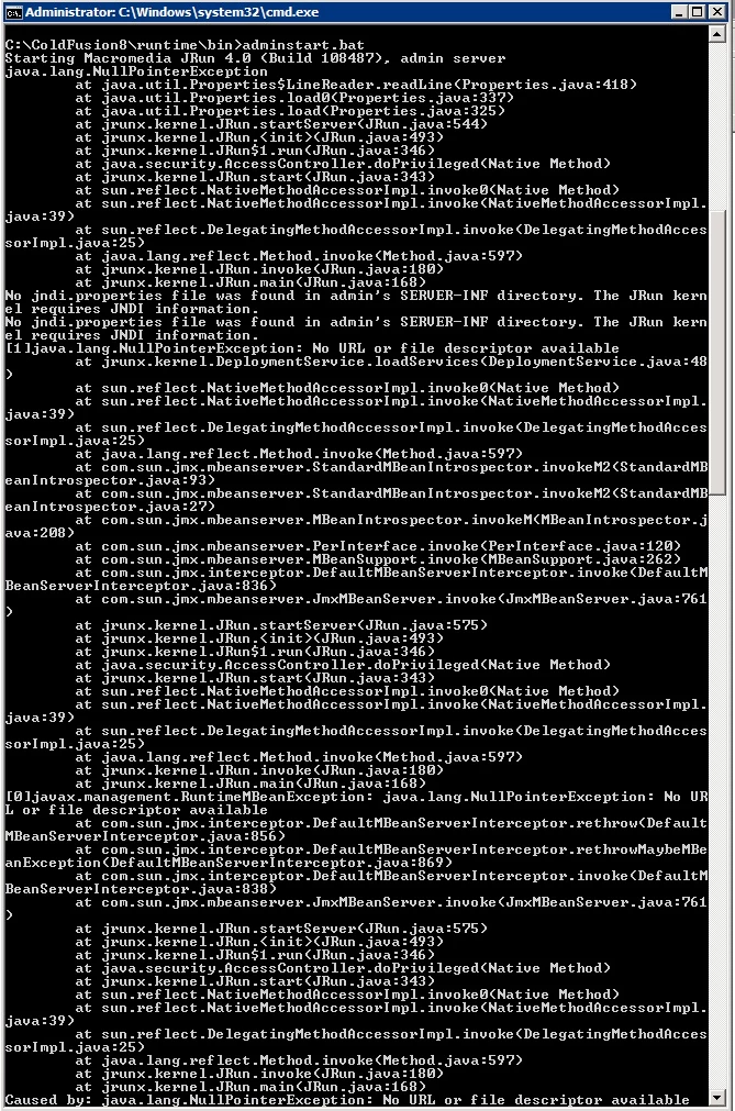

Bahkti recommended I run adminstart.bat from within the console instead of double clicking on it. I did, and the screenshot is attached. I would've copied and pasted the results, but it's a lot of code.
CF Builder is installed on a Mac running OS 10.5.7. The remote server is running Windows Server 2008 with a licensed, standalone version of ColdFusion 8. It is our team's inhouse testing server, not production.
Any help would be appreciated. Thanks.
