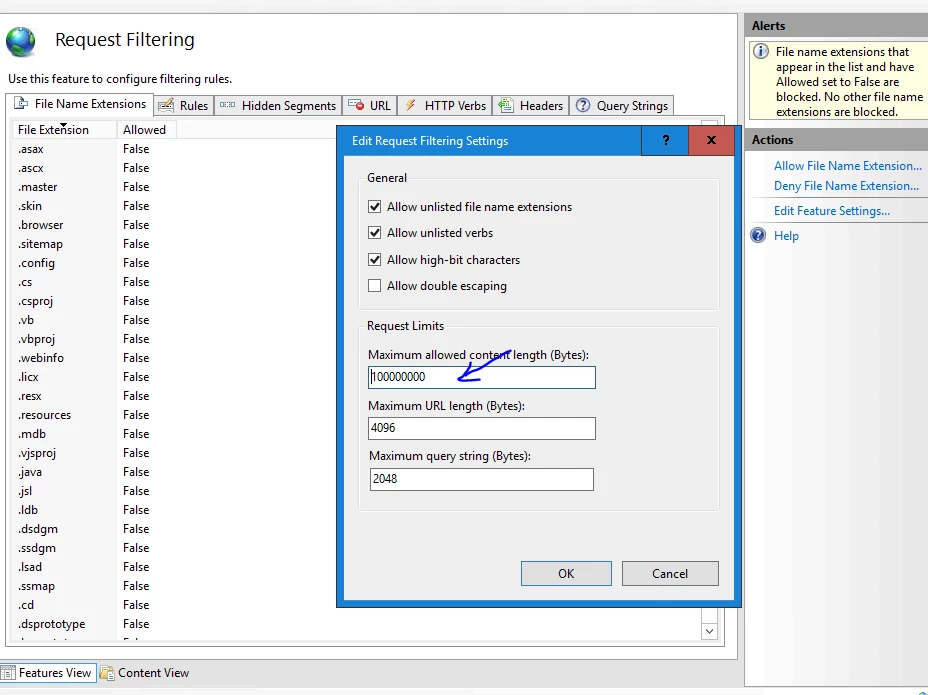

Feb 13, 2024 1:43 PM UTC
When I've seen that error, it's been at the web server level.  Not ColdFusion.  Check your web server settings to see what the maximum request size is set at.  If you have multiple web servers, this will need checked on each one.  I know in IIS this setting is in the Request Filtering area.

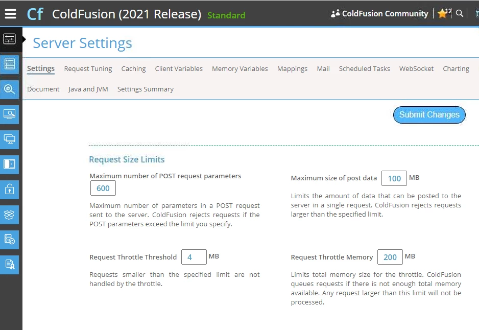

You could also check the Maximum Post size in the CFAdmin settings.
Feb 13, 2024 10:46 PM UTC
Hi @sdsinc_pmascari ,
Thanks for the reply.
I think you are referring to this IIS setting.
and this CFSetting.
As you can see, they are both set at about 100MB.  The file that I had issue with was not even 1MB in size.
