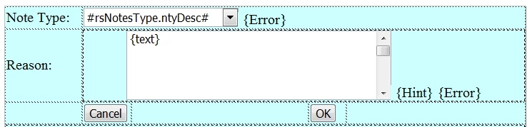

I have an Insert Form like so:
with <form method="post" id="form2" action="<cfoutput>#Request.KT_escapeAttribute(Request.KT_getFullUri())#</cfoutput>">
        <input type="submit" data-mini="true" name="Insert1" id="Insert1" value="OK" />
I also need to run the following Update Query if the User clicks on OK..

    November 29, 2012
    The solution was to wrap my UPDATE querie(s) in the following cfif:
    <!--- Hold off doing the Update unless the the form has been submitted --->
    <cfif isdefined("form.KT_Insert1")>
    <!--- Update the Status to Rejected in the tbltickets table --->
          <cfquery datasource="care">
        UPDATE tbltickets
    SET ttstatus=<cfqueryparam value="Rejected" cfsqltype="cf_sql_varchar">
    WHERE ttNum=<cfqueryparam cfsqltype="cf_sql_varchar" value="#url.id#">
      </cfquery>
    </cfif>
