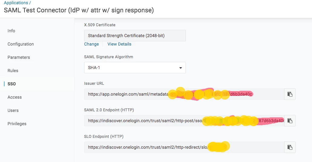

    3. From my CF app , when I send auth request to IdP using <cflocation> tag then the URL should be the one mentioned against SAML 2.0 Endpoint (HTTP) as shown in the below attached image. Am I correct?.
    Note : OneLogin is my Idp.

    3. So yes you could send the request to the IDP using that SAML 2.0 endpoint.  But if you are just planning to receive the return directly in your CF app then you will have to encode and decode both messages (sent and received). Which ultimately will mean implementing your own SAML 2.0 compliant handling.  That is why I chose to use ShibbolethSP and simpleSAMLPHP.  Those 2 applications will handle all the SAML compliant stuff for me and I just take the returns.  So in my case I actually set up a seperate apache/httpd server with simpleSAMLPHP installed as my intermediary SP.  Lets call it auth.application.com.  And app.application.com is my CF app.  So in app.application.com when a user selects (or has a cookie that identifies them as) SSO I identify which IdP they are based on the cookie or email then forward them to a 'secured' address on my auth server: auth.application.com/sampleIDP/.  This path is set in the SP configuration to require login and be associated with the sampleIDP entity id.  So then simpleSAMLPHP performs the saml hand-shake and sends the user to sampleIDP login.  After logging in the sampleIDP returns the saml request to auth.application.com where a processing script parses the attributes, creates the UUID and saves to a DB before passing the UUID to a processing script on the application server (for example: app.application.com/process_sso.cfm.  This then receives the token checks the authDB for the values and performs login operations if the user is found.  We can also do other things like JIT (just in time) provisioning with this process if a client desires (though in general that can be a bit of a can of worms!!).
