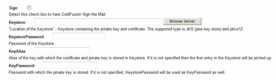

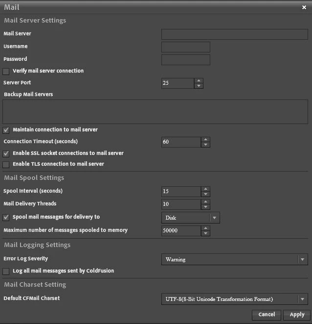

CF Server Manager does not have options for some of the CF9 Server Settings > Mail details. These ones are not accessible via CF Server Manager:
-Sign, Keystore, KeystorePassword, KeyAlias & KeyPassword
Eg:
CF Server Manager Mail
CF9 CFadmin UI portion
Should Server Manager have the "secure" mail settings available for editing?
Thanks in advance, Carl.

    Interesting to hear, Carl. Are you raising that seeking confirmation from others? or pointing it out as a problem that needs to be fixed?
    If you're seeking confirmation, I can confirm that I also do not see that, in a CF 9.0.1 updated server with the latest CHF.
    If you're pointing it out in the hopes of it being fixed, of course you'll want to raise it instead to the product team: http://cfbugs.adobe.com/
    Hope that's helpful.
    /charlie

    Hi Charlie,
    Thanks for confirming. I have raised bug number 86979.
    Server Manager can be so useful then at same time fall short as a method of managing CF9 server and multiserver. Hopefully Adobe CF team will take a closer look at Server Manager in CF version X / 10 / Zeus since it can be very practical for CF administrators.
    Cheers, Carl.
