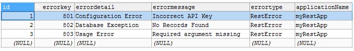

Create a database table, errorCodes, and register it as datasource in the ColdFusion administrator. It will have data as in the following example:
Corresponding to this table will be the CFC errorcodes.cfc, containing the init.
errorcodes.cfc

All the caller has to do is pass the application's name along with the other arguments in the REST call. The REST CFCs will be something like
