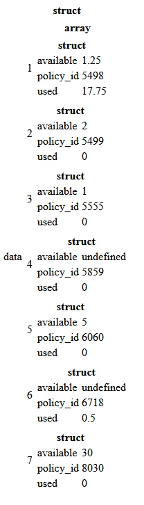

One thing we do often as we develop is use CFDUMP to view the contents of variables and objects as we're coding.  We've grown quite fond of ColdFusion's neat little CFDUMP tables that make viewing objects so convenient such as this little example:
However, since installing CF2018, CF when we use a CFDUMP inside a CFC we no longer get this nice view.  We get a plain old HTML table that's much harder to read..especially as the objects grow much larger:
Viewing the source code of the dumped page, CF is not inserting the CSS nor JS for it's CFDUMP tables when used within a CFC.

    Just to follow up on this - we also recently moved from 2016 to 2018 and are seeing this issue.
    The weird thing is I see this on our development server (native install on Windows), but in my local dev environment (Commandbox Docker) I get the correct blue styled error screen.
    And of course this worked fine on CF2016 in both environments.
    And I am NOT calling the dump within a CFC. Its basically a FW/1 app, I have an error() method in my main which does some logging, and then in my error.cfm view - I call cfdump.

    Charlie, I looked into the Network tab and there is nothing.  There never would be because the CSS and JS that are needed to format the DUMP look to be coded into the page if you view the source code.
    So, I examined the CFFiddle and copied it to my environment and it, too, worked as expected.  The dump is formatted as expected.
    However....most CF coding in our shop is still done in tags.  So, for giggles I rewrote your little test using tags in the CFC and there it is:
    https://cffiddle.org/app/7c53bab1-8ecc-4062-9df8-80561d68b158
    The CFDUMP in a CFC when the functions are tags, rather than script, the formatting disappears.
