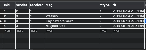

So tired solving this problem, Help please
This is my table for messages
I'm trying to pull data from only mid no 1 and mid no 4, basically my goal is to get the last message from every sender
First i created a query to pull all the message for a user, in this case receiver id is 1
<cfquery name="messages_tb" datasource="appdb">
    SELECT * FROM messages
    WHERE receiver = <cfqueryparam value="1" cfsqltype="cf_sql_integer">
</cfquery>
then i created a list of every sender id
<cfset list.messages_tb_sender_uid = ValueList(messages_tb.sender)>
after that i did this
    SELECT MAX(mid) as last_id from messages
    WHERE sender IN ( <cfqueryparam value="#list.messages_tb_sender_uid#" cfsqltype="cf_sql_varchar" list="yes">)
    and receiver = <cfqueryparam value="1" cfsqltype="cf_sql_integer">
</cfquery>
<cfset list.messages_tb_last = ValueList(messages_tb.last_id)>
<cfoutput>
    #list.messages_tb_last#
</cfoutput>
The problem is im getting only 1 row, i dont wanna use loop or output query. Is there any way to just create a list of last mid of every sender ?

If that last valuelist has only 1, then the messages_tb query has only one record.   Do a cfdump of the query  to confirm. So this is not a cfml problem but a sql one.
I would think you could do a simpler single select, whether with group by or subqueries, but a) I'd have to build out a test table to be sure my proposal was right and b) I'm on my phone.
My guess would be that this could work:
SELECT   sender, MAX(mid)
FROM      messages
GROUP BY sender
But if not, it could help if you used querynew and related functions to create a simulated query result, against which folks could then try to do a qofq in cfml, and in cffiddle.org or trycf.com, even from a phone. (Sure, we could "just do it". I'm proposing how you could help us help you.)
It may also help to know what dbms/version you're using, as some problems are best solved using db-specific features--as long as you don't favor cross db compatibility over efficiency. For instance, windowing function if in more recent versions of sql server can do amazing things.
/Charlie (troubleshooter, carehart. org)

Jul 4, 2019 12:22 PM UTC
Thank you soooo much, it works like a charm!
Thanks a ton man, You just made my year This problem was eating me alive ! not anymore
