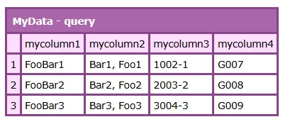

    I have been able to reproduce the issue. The following CF2023 test-code dumps a query and writes the same data to an XLSX file.
    <cfset mydata = queryNew("mycolumn1,mycolumn2,mycolumn3,mycolumn4", "varchar,varchar,varchar,varchar",
    	[{"mycolumn1"='FooBar1',"mycolumn2"='Bar1, Foo1',"mycolumn3"='1002-1',"mycolumn4"='G007'},
    	{"mycolumn1"='FooBar2',"mycolumn2"='Bar2, Foo2',"mycolumn3"='2003-2',"mycolumn4"='G008'},
    	{"mycolumn1"='FooBar3',"mycolumn2"='Bar3, Foo3',"mycolumn3"='3004-3',"mycolumn4"='G009'}])
    <cfset writeDump(var=mydata, label="MyData")>

    The query contains the expected data. However, the spreadsheet functions seem to have converted the strings "1002-1", "2003-2" and "3004-3" to dates, even though mycolumn3's datatype is varchar.

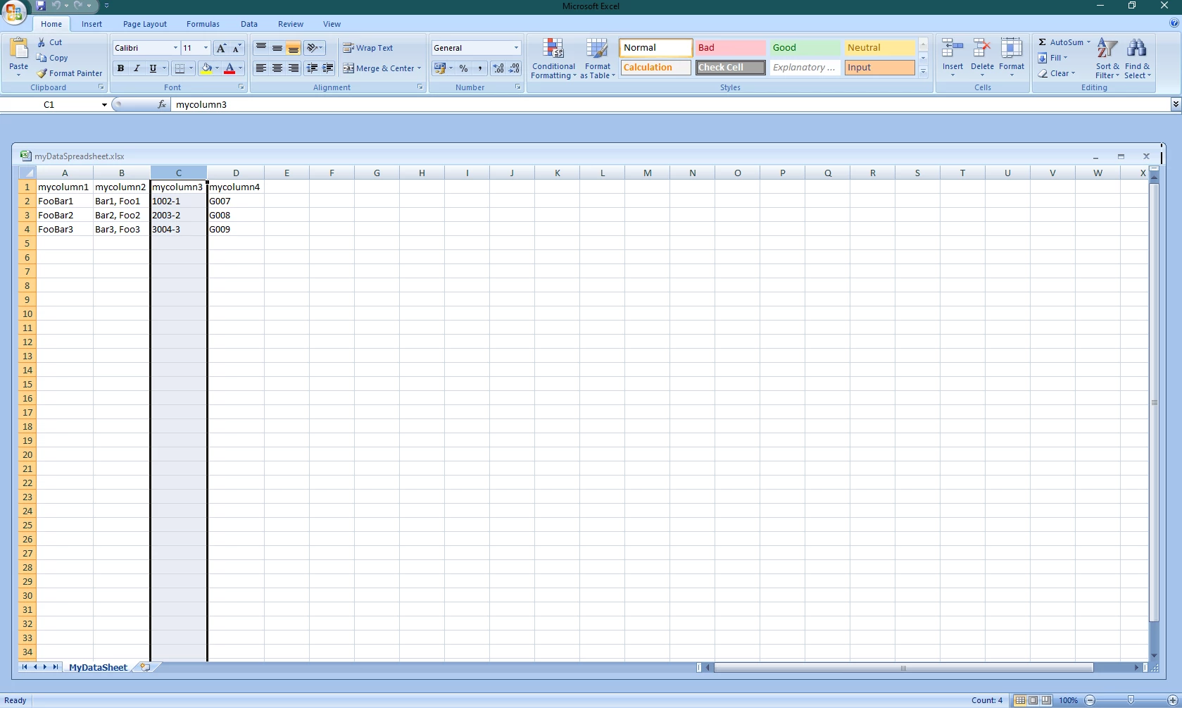

    Here is a strategy: search the list of ColdFusion's spreadsheet functions for an appropriate one that explicitly sets the datatype. One such function is SpreadsheetSetCellValue: SpreadsheetSetCellValue(spreadsheetObj, value, row, column, datatype)
    Using this strategy I found the following workaround:
    	[{"mycolumn1"='FooBar1',"mycolumn2"='Bar1, Foo1',"mycolumn3"=javacast('string','1002-1'),"mycolumn4"='G007'},
    	{"mycolumn1"='FooBar2',"mycolumn2"='Bar2, Foo2',"mycolumn3"=javacast('string','2003-2'),"mycolumn4"='G008'},
    	{"mycolumn1"='FooBar3',"mycolumn2"='Bar3, Foo3',"mycolumn3"=javacast('string','3004-3'),"mycolumn4"='G009'}])
    <!--- Create a spreadsheet object with sheetname MyDataSheet --->
    <cfset spreadsheetObj=spreadsheetNew("MyDataSheet",true)>
    Add rows with data from query result.
    The first row consists of the columns.
    The spreadsheet will have column names mycolumn1, mycolumn2, ...
    The data start from row 2, col 1.
    <cfset SpreadsheetSetCellValue(spreadsheetObj, "mycolumn1", 1, 1, "string")>
    <cfset SpreadsheetSetCellValue(spreadsheetObj, "mycolumn2", 1, 2, "string")>
    <cfset SpreadsheetSetCellValue(spreadsheetObj, "mycolumn3", 1, 3, "string")>
    <cfset SpreadsheetSetCellValue(spreadsheetObj, "mycolumn4", 1, 4, "string")>
    <cfloop query="mydata">
    	<cfset SpreadsheetSetCellValue(spreadsheetObj, mycolumn1[currentRow], currentRow+1, 1, "string")>
    	<cfset SpreadsheetSetCellValue(spreadsheetObj, mycolumn2[currentRow], currentRow+1, 2, "string")>
    	<cfset SpreadsheetSetCellValue(spreadsheetObj, mycolumn3[currentRow], currentRow+1, 3, "string")>
    	<cfset SpreadsheetSetCellValue(spreadsheetObj, mycolumn4[currentRow], currentRow+1, 4, "string")>
    </cfloop>
    <cfset dirName=GetDirectoryFromPath(GetCurrentTemplatePath())>
    <!---Write spreadsheet to a file myDataSpreadsheet.xlsx in the current directory--->
      <cfset SpreadsheetWrite(spreadsheetObj,"#dirName#myDataSpreadsheet.xlsx",true)>
