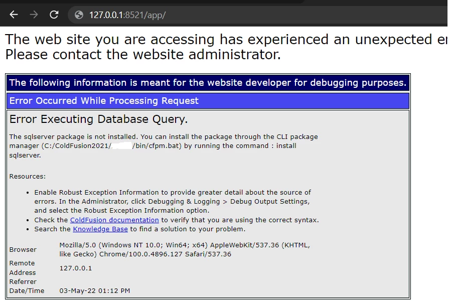

Cuando hago la modificación del Contexto de mi aplicación e intento ingresar me devuelve un error diciendome que no tengo instalado el paquete de Sql server.
Error:

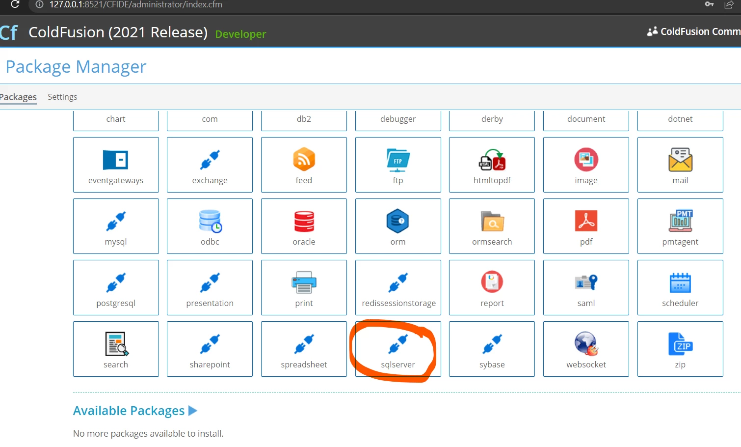

El paquete de Sql Server si lo tengo instalado:
El error surge solamente después de hacer la modificación del Context en mi server.xml.

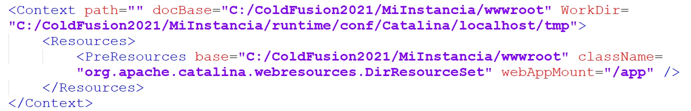

    While I can't explain how the problem leads to the error about the module, I can say that there's a different way to create a virtual directory in tomcat (in that server.xml file). Instead of defining /app in the context element like you do, define it in a preresources element (within a differently defined context element). See a discussion and examples here:
    https://www.petefreitag.com/item/867.cfm
    As he notes, this is the way to do it in tomcat 8.5 and above, which cf 2021 and 2018 use or exceed. I know you say the old way worked for you in 2018. Maybe you really meant cf2016 (and FWIW, the Tomcat version cf uses has changed WITHIN cf versions when Adobe has offered "refreshed" installers). But let's not quibble over that, if this gets you going.
    Please do let us know if this works for you.

    Muchas gracias Charlie,
    En efecto la solución fue poner mi alias en un PreResources, te comparto como quedó mi context:
    Te agradezco mucho tu ayuda.
